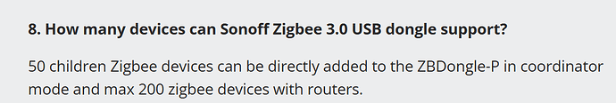

Second thing you need to watch out for is how many devices are connected to your coordinator directly. The Dongle-P page has some inconsistencies regarding how many direct connections it can handle.
The main product page says it’s 21 direct connections & 40-100 children via firmware update:
Meanwhile the FAQ section at the bottom says 50 direct connections & up to 200 children:

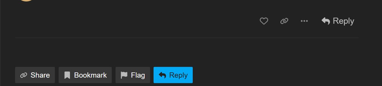

PS - next time you want someone to be notified you replied to their post, use the grey reply button at the bottom of their post instead of the blue one at the bottom of the thread. I only stumbled on your reply by accident
