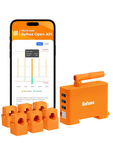

I have 2 times in my house the EM06 from refoss. Working fine for more than a year now.
There is a new version of it that fits maybe your needs:
Also info on the forum here:
