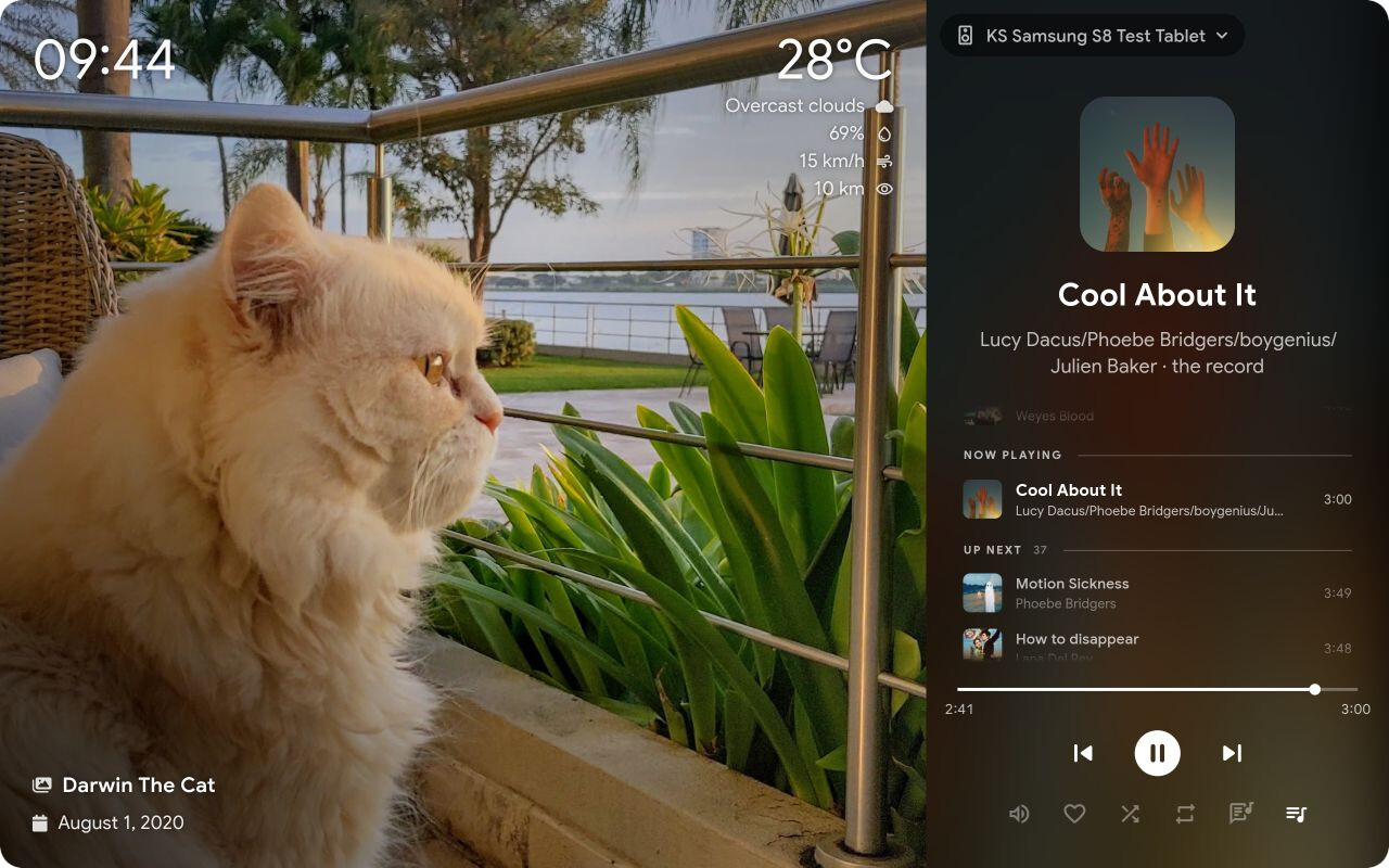

Photo screensaver with clock, weather and music controls
For anyone who hasn’t seen it, it’s an Android app that brings your HA dashboard, hands-free voice control, music playback and photo screensavers together on one device. It runs locally and is free for personal, non-commercial use.
The idea is to make a tablet useful throughout the day, whether you’re controlling your home, asking Assist a question, listening to music or displaying family photos.

  • Screensavers: Immich albums, local photos and clocks, with motion, face or presence detection to wake the display.

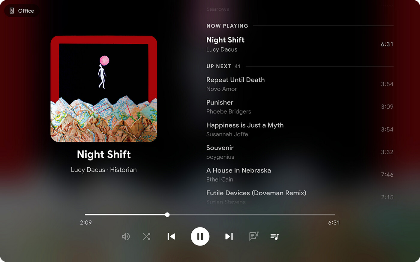

Here’s the full-screen music view:

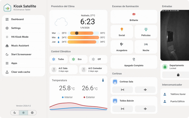

And a camera view:
