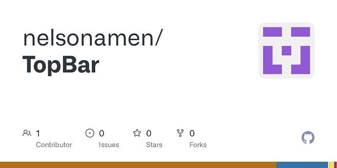

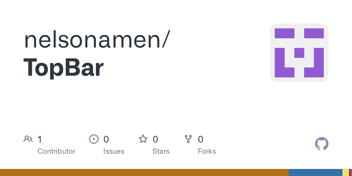

Plugin Release: TopBar for Kiosk Satellite
Hi! I’ve just released a plugin for Kiosk Satellite called TopBar. It adds a floating control bar to your kiosk screen, giving you quick access to your favorite Home Assistant actions directly on top of your dashboard.
@nelsonamen that’s really good looking, thank you for sharing!
