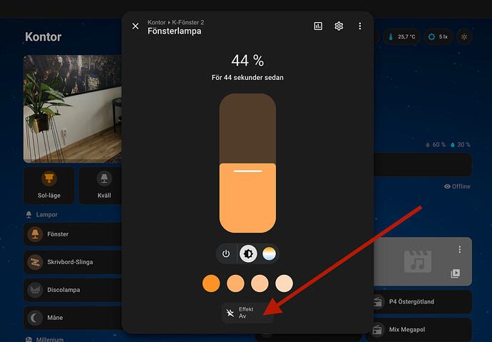

The flicker effect is available in HA with my Hue. But I use them in HA via the Hue hub, could be the reason perhaps ... I have not tried to install them directly into HA.
Yes, I tried that -- the BT/Matter Hue Essentials bulbs I have did not provide effects in HA, and the hub's limited range proved an issue.

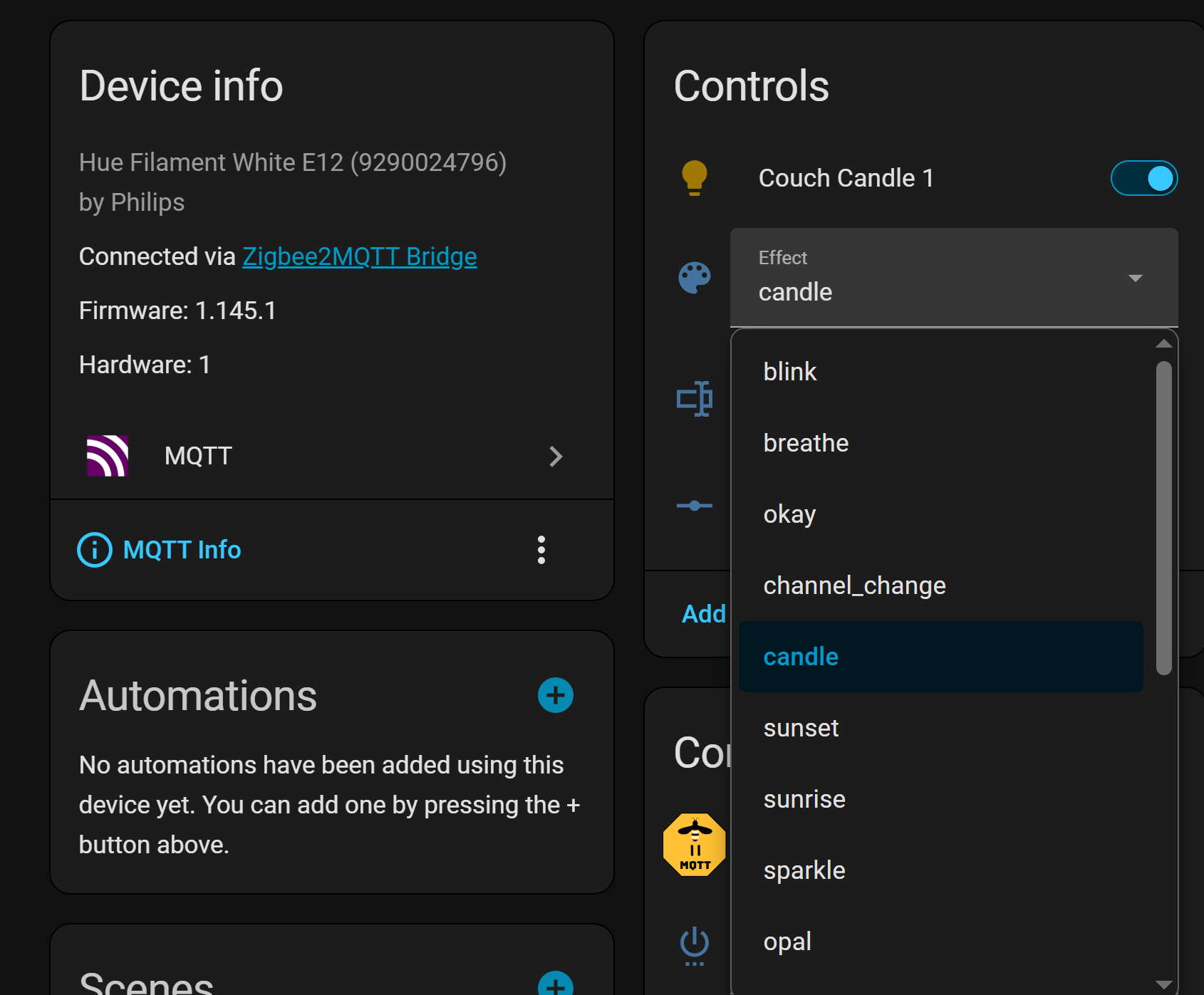

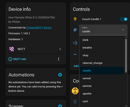

Hue bulb Effects are accessible in HA even when connected without the Hue Hub.
effect_list: blink, breathe, okay, channel_change, candle, sunset, sunrise, sparkle, opal, glisten, underwater, cosmos, sunbeam, enchant, none, finish_effect, stop_effect, stop_hue_effect

Woah, hang on, how have you got that?
Oh, Z2M :frowning:
They aren't available in ZHA.
Yes I’m using Z2M
