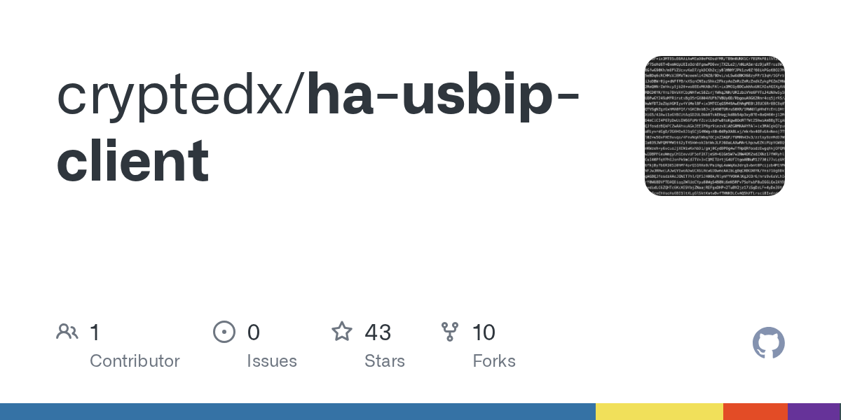

You can install the USBIP server on just about anything and serve the attached USB device to HA.
According to reddit it handles live migration:
I've used this successfully if it's what you're looking for:

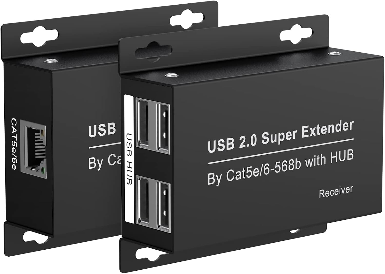

Very interesting! So you buy a pair of these and it forms a transparent bridge with native USB drivers on the client side?
Note: I am pretty sure this ONLY uses the cable--it is NOT on an Ethernet network.
Thanks, that is an important distinction!
Yes - I use something similar to connect a mouse to my NVR. The NVR is in the data rack and the CCTV monitor and mouse are about six metres away across a hallway. The monitor also connects to the NVR via an HDMI to Ethernet adapter.
They do not through the LAN switch. They just use the ethernet cable like an extension cord.
Correct - the Amazon link I posted just uses cat5/6 cabling for transport, it doesn’t use ethernet networking. Not sure if that helps.
I used it to put usb PiAware antennas in my attic and bring them down to my server closet. Worked well for that.
