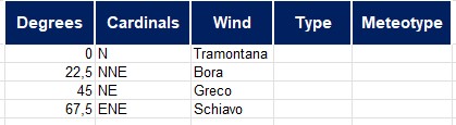

i’m just working on this lookup table as example training:
t
  • o be used/reused for multipurpose
  • value stored on an attributes template sensor
From what I learnt should be a dictionary, I suppose like that:
serie1: [ “id”: 0. “cardinals”: N, “wind”: "tramontana, “type”: “string”, “meteotype”: “string”]
serie2: [ “id”: 22.5. “cardinals”: NNE, “wind”: "bora, “type”: “string”, “meteotype”: “string”]
serie3: [ “id”: 45. “cardinals”: NE, “wind”: "greco, “type”: “string”, “meteotype”: “string”]
and so on
I got a variable where is the value “degrees” and to be used as key item,
to retrieve data value eg. “Wind” based on degress
I suppose ( not so expert) should be used >> for…endfor
“I dont know” how to implement and write in right way
Help and suggestios are more than wellcome :slight_smile:

said that......j would like to use the table as "multi purpose".
excuse me i dont have the property of right semantic.
I try to explian in better way
scenario
Test.yaml
template:
  • sensor1:
    attributes:
    a1: table [degrees]
    b1: table: table [meteo]
  • sensor2:
    attributes:
    a2: table [cardinals]
    b2: table [meteotype]
Where to write/define the table structure?
i write TABLE once time and then i call on a1,b1,a2,b2 and so on
I’m lost here on this point
I mean; on a1 “block definitions” is “easy”,
I set “goofy” with degrees value
i call “table” with the sentence:
{{ table | selectattr(“degress”, “eq”, goofy) | map(attribute=“id”) | list | first }}
I get the result as my expectations
