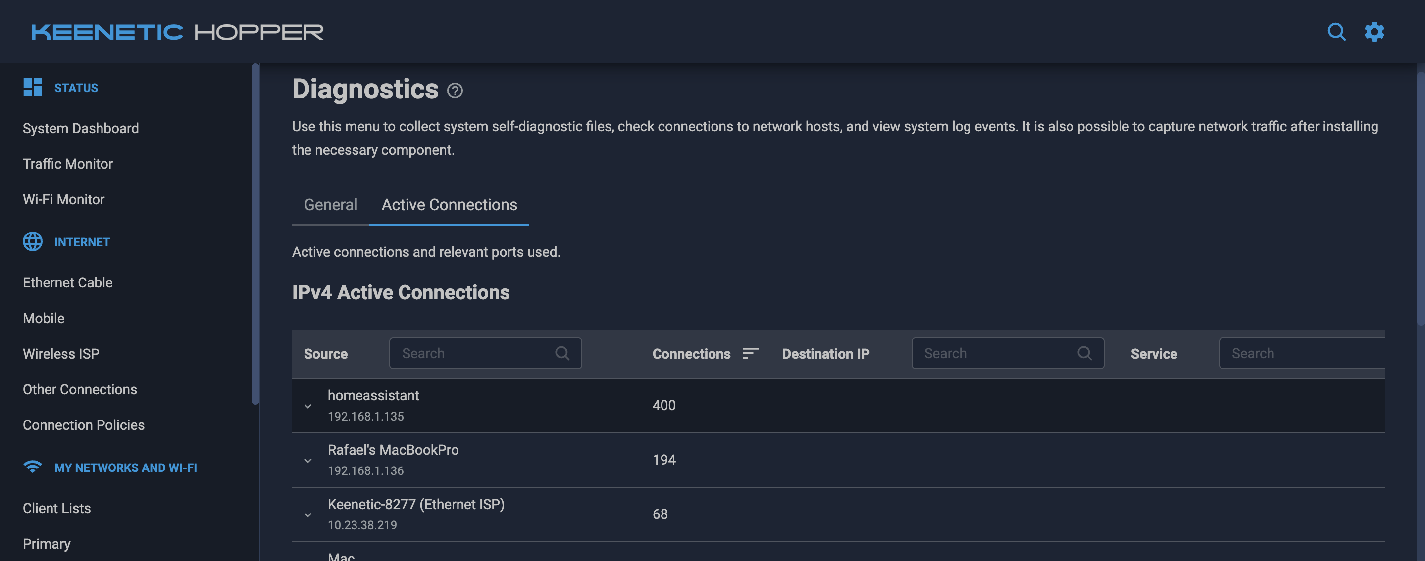

I found the issue.
I had enabled external access to my Home Assistant using a Keenetic Cloud URL. It was generating too many connections — the last time I checked, there were around 3,500 active connections. This was causing my entire network to drop.
I removed the cloud access, and now everything seems stable. I’m going to switch to Tailscale instead.
Thank you all for your help. I hope this information helps someone in the future if they face the same issue.
