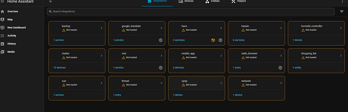

This below is the kind of chaos I am usually greeted with after a restart, everything is unhappy.

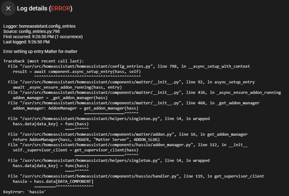

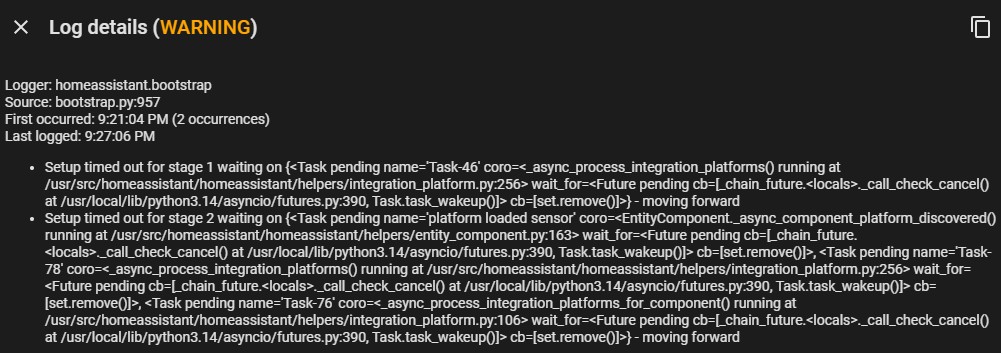

If I go into the logs these are the three I’m presented with, from what I can tell its timing out and not starting everything correctly, but a simple restart doesn’t fix this, 5 or 6 might, but there seems to be no logical rhyme or reason to it. I’ve done a lot of googling but can’t really find anything which is pointing me towards anything obvious.

My only theory I have is that the hardware (Nuc) isn’t keeping up and it’s just not processing fast enough during startup. But I would of thought when people run HA on Rasperri Pi’s that even a old/slow Nuc would be more than sufficient, especially when it’s barely got any devices connected to it, but maybe (quite likely) I’m wrong. When it eventually finds all the integrations and devlces there seems chug along fine with no issues, but getting from where I am now to that point is the issue. Any reccomendations would be fantastic, the back end troubleshooting is a bit over my head.

Matter Error Log

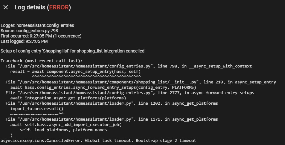

Shopping List error
Final timeout error
