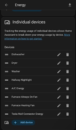

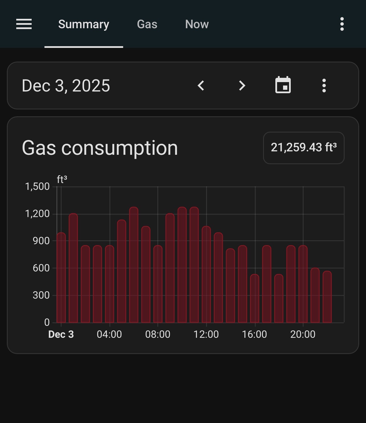

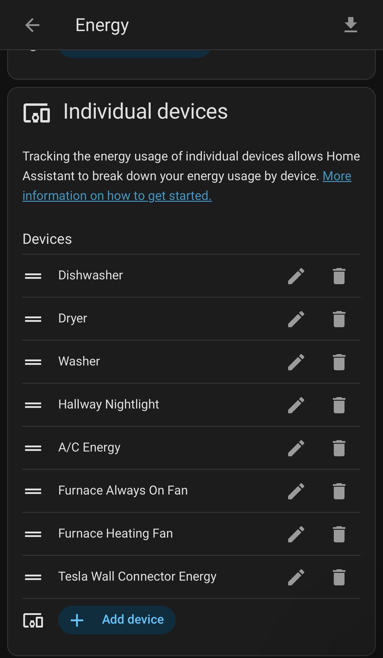

I recently upgrade my HA installation to 2025.12.0 and I have this issue where I’ve lost my energy (electric) consumption in the energy dashboard. All my individual devices (smart plugs, no whole home monitoring) are still added, but only my gas consumption shows.
All that aside, I’ve uploaded screenshots here. I’m curious to see if anyone has had this problem or maybe I’m missing something.

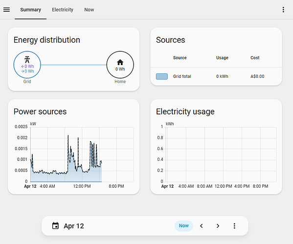

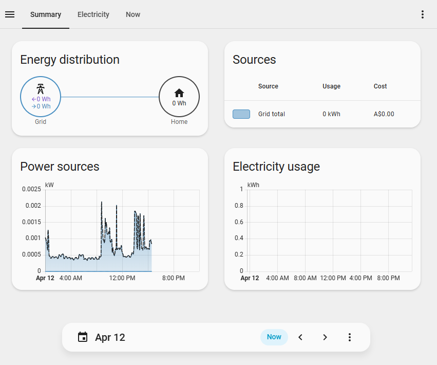

I also have a similar issue.
I have the electricity section populated with a whole of home sensor. HA thinks that sensor measures in Watts (when it is in fact kW). It also displays the correct class. I would not expect the incorrect reading of the watts/kilowatts to be the issue, but maybe??
Strangely, the state/values show up only INTERMITENTLY in the default ‘Energy’ dashboard, however, I can ALWAYS see the sensor reading in real-time on a manually created ‘Energy Monitoring’ dashboard - my home is always consuming some amount of energy and we do not have solar contributing back to the grid although I do have a battery that leaks some energy (minute amounts) back to the grid, hence have added an export entity to track this.
Would love to be able to use the out-of-the-box functionality dashboard functionality!
