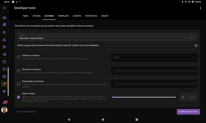

To go a step further, I also used Spook to identify remaining orphaned entities in the database, and I manually triggered a purge with the following service call:
service: recorder.purge_entities
  keep_days: 0
  repack: true
  entity_globs:
    - sensor.*
    - media_player.*
This was intended to clear historical data related to those ghost entities and reduce database size.

FYI… This service call removes entities from the database. Seems like you may have removed all your sensors and media players. I use this service when I need to get rid of an entity I am not using anymore, because I have deleted it.
This should have been a list of the orphaned entities.
  keep_days: 0
  repack: true
  entity_globs:
    - sensor.*
    - media_player.*

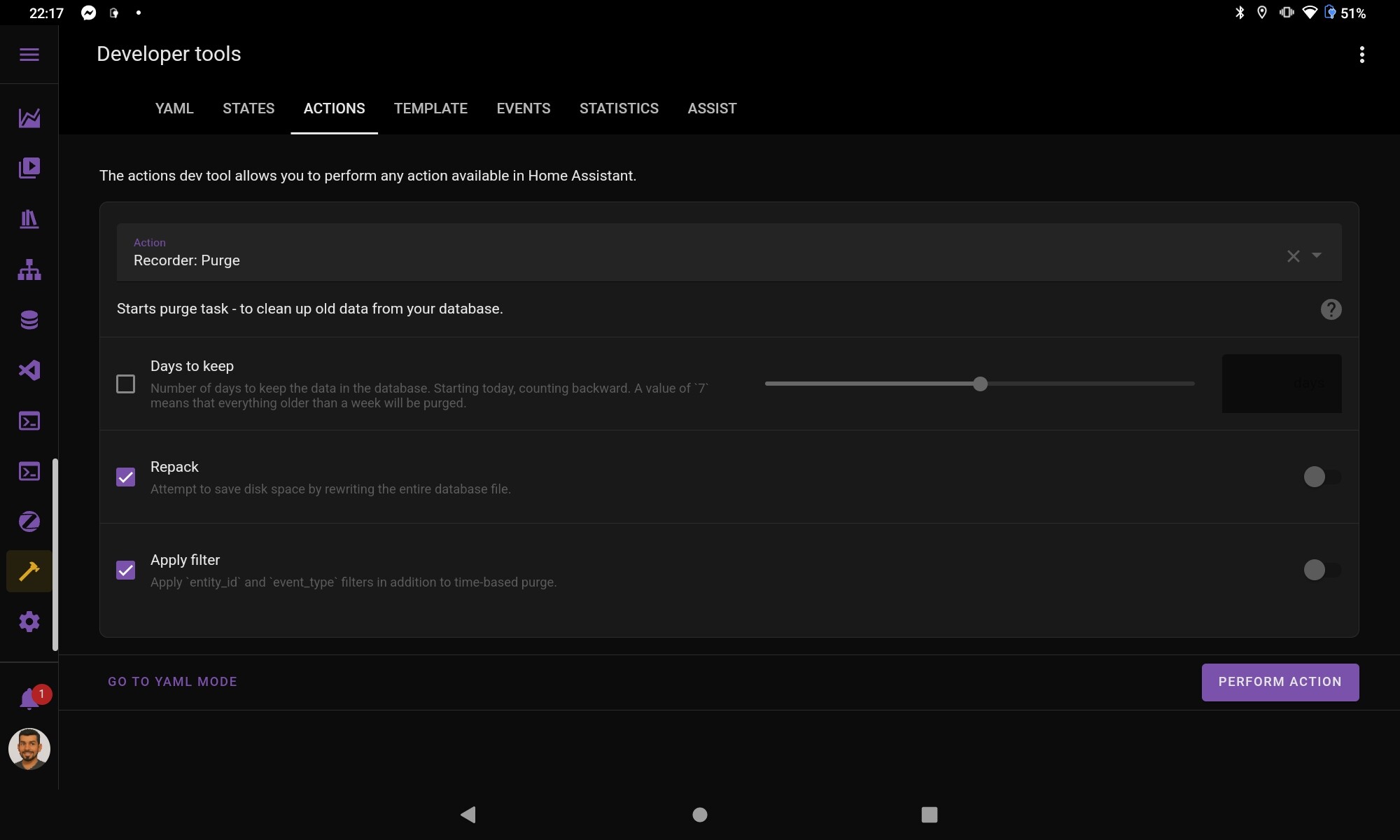

This is probably the one you should have used
