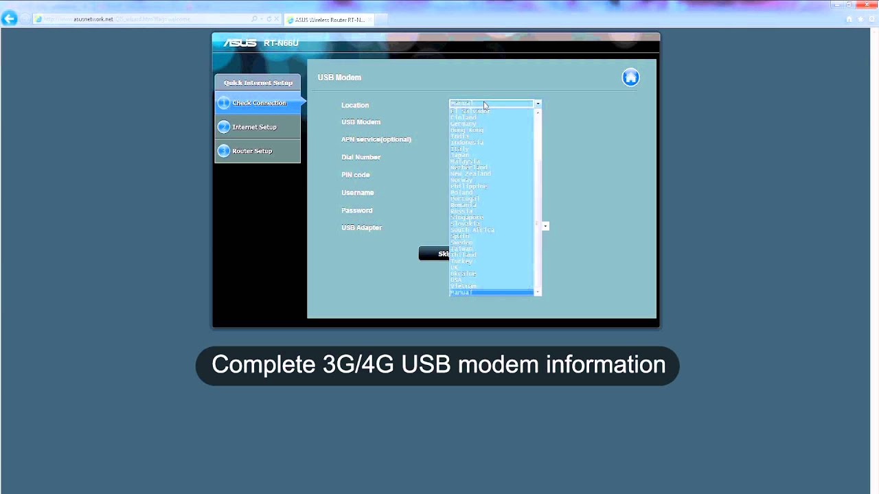

Check your ASUS router. Just about all of them now will tether a cell phone to the USB port. Great way to keep things working if primary service is down.
You know, I think mine does have that, never looked into it. Is it that simple? Just plug my phone (with hotspot enabled) into the usb port? Nice, and great option!
I would be interested to know how that works as well.
I just did a bit of reading, and it looks like it only works with Android. :frowning:
but if you do have androit, it looks very simple. Plenty of simple guides online.
I hqve a 3g modem connected as backup. Its a usb stick and the router use it when normal line is down. If you have 4g it is even better
Is this an Asus router? I’m wondering if my netgear supports this.
No itsan avm router but most modern routers do I think. Its like having a router with two wan ports.
Check the docs for my 8300, no mention of this feature ;(
You will have to check the USB port settings on your router. A firmware update may be needed.

I have a netgear modem running ASUSWRT merlin firmware as this firmware has dual WAN (failover/failback). I use a netgear LB2120 4G LTE modem as backup for my fibre. It was relly handy when my previous ISP went bad (they stopped buying enough backhaul).
