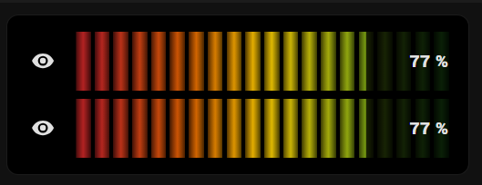

Home assistant 2025.5
After update the gradient stopped working

        bar-card-backgroundbar {
          background: linear-gradient(to right, green 20%, yellow 40%, orange 60%, red 80%, purple 100%);
          border-radius: 25px;
        bar-card-currentbar {
          clip-path: polygon(0 0, var(--bar-percent) 0, var(--bar-percent) 100%, 0 100%);
          mask-image: repeating-linear-gradient( 90deg, transparent 0px, black 5px, transparent 0px, black 5px);
        bar-card-contentbar {
          font-size: 14px; color: white;
        bar-card-value  {

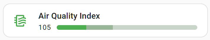

type: custom:bar-card
entities:
  - entity: sensor.air_quality_bedroom_voc_index
    icon: mdi:air-filter
    positions:
      icon: outside
      indicator: "off"
      minmax: "off"
      value: "off"
    height: 8
    min: 0
    max: 500
    target: 200
severity:
  - color: rgb(76,175,80)
    from: 0
    to: 199
  - color: rgb(255,152,0)
    from: 200
    to: 349
  - color: rgb(244,67,54)

card_mod:
  style: >
    {% set entity = {
      "state": states('sensor.air_quality_bedroom_voc_index') | int(9999999999),
      "name": "Air Quality Index",
      "unit": ""
    %} {% set severity = {
      "green": 0,
      "orange": 200,
      "red": 350
    %} {% set colors = {
      "green": "76,175,80",
      "orange": "255,152,0",
      "red": "244,67,54"
    %} {% set action = false %}
    ha-card .card-content {
      padding: 10px!important;
      cursor: pointer;
    ha-card {
      transition-duration: 0.05s;
    ha-card:hover {
      {% if entity.state == 9999999999 %}
        background-color: rgba(200,200,200, 0.02);
      {% elif entity.state < severity.orange %}
        background-color: rgba({{colors.green}}, 0.02);
      {% elif entity.state < severity.red %}
        background-color: rgba({{colors.orange}}, 0.02);
      {%- else -%}
        background-color: rgba({{colors.red}}, 0.02);
      {%- endif %}
    bar-card-background {
      margin-left: 13px !important;
    bar-card-backgroundbar, bar-card-currentbar, bar-card-contentbar,
    bar-card-targetbar {
      border-radius: 8px !important;
    bar-card-currentbar, bar-card-backgroundbar, bar-card-contentbar,
    bar-card-targetbar, bar-card-animationbar {
        left: 1.5em !important;
        right: 0.5em !important;
        width: auto !important;
      {% else %}
        {% set state_width = 1 + (entity.state|string|count + entity.unit|count) * 0.4 %}
        left: {{state_width}}em !important;
      {%- endif %}
    bar-card-markerbar {
      display: none;
    bar-card-background::before {
      content: "{{ entity.name }}";
      display: flex;
      font-family: Roboto, sans-serif;
      font-size: 14px;
      font-weight: 500;
      height: 20px;
      letter-spacing: 0.1px;
      line-height: 20px;
      margin-bottom: 6px;
    bar-card-background::after {
        content: "N/A"
      {%- else %}
        content: "{{ entity.state }}{{ entity.unit}}";
      {%- endif %}
      font-family: Roboto, Noto, sans-serif;
      font-size: 12px;
      font-weight: 400;
      height: 16px;
      letter-spacing: 0.4px;
      line-height: 16px;
      display: inline-block;
      position: absolute;
      margin-top: -4px;
      width: fit-content;
    bar-card-iconbar {
      {% if action %} {% set alpha = 0.2 %}
      {% else %} {% set alpha = 0 %} {% endif %}
        color: rgba(200,200,200, 1) !important;
        background-color: rgba(200,200,200, {{alpha}});
        color: rgba({{colors.green}}, 1) !important;
        background-color: rgba({{colors.green}}, {{alpha}});
        color: rgba({{colors.orange}}, 1) !important;
        background-color: rgba({{colors.orange}}, {{alpha}});
      {% else %}
        color: rgba({{colors.red}}, 1) !important;
        background-color: rgba({{colors.red}}, {{alpha}});
      {% endif %}
      border-radius: 50%;
      max-height: 36px;
      max-width: 36px;

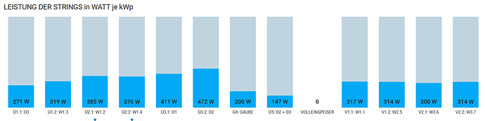

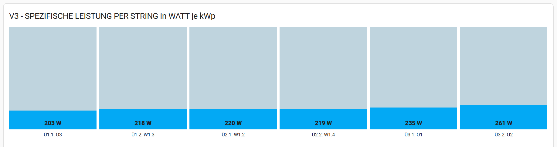

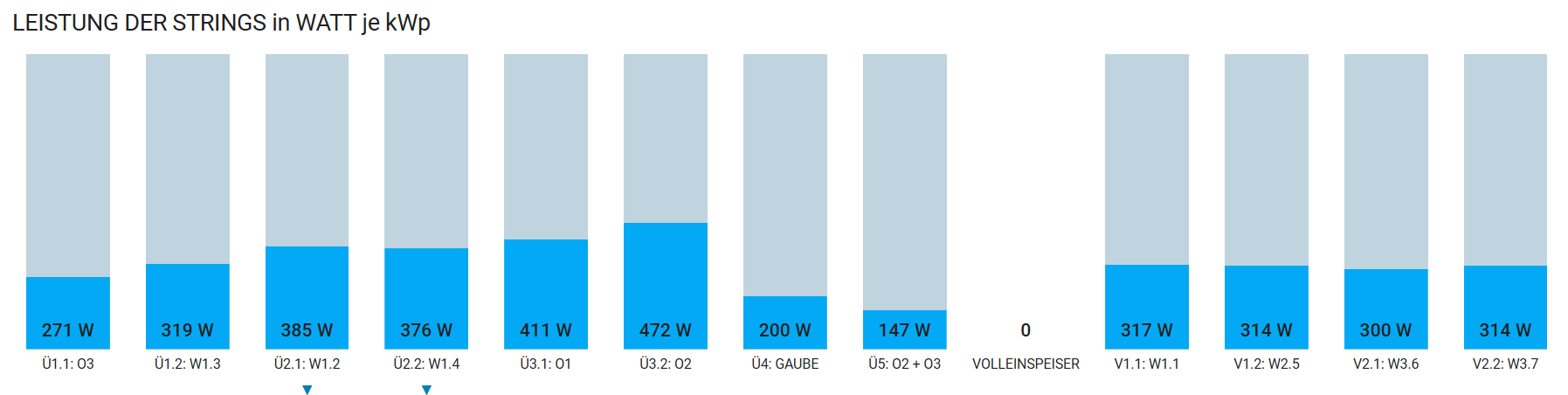

I have tried to implement your solution to get this kind
but I got that instead this which looks like what Ihave had before
I used this code (I have changed the background colour to white and the font size / weight)
type: custom:stack-in-card
cards:
  - type: custom:bar-card
    columns: 0
    direction: up
    stack: horizontal
    height: 300px
    width: 75%
    decimal: 0
    entity_row: false
    positions:
      icon: "off"
      minmax: "off"
      indicator: outside
    min: 0
    max: 1100
    animation:
      state: "off"
      speed: 5
    entities:
      - entity: sensor.u1_1_leistung_pro_kwp
        min: 0
        max: 1100
      - entity: sensor.u1_2_leistung_pro_kwp
        min: 0
        max: 1100
      - entity: sensor.u2_1_leistung_pro_kwp
        min: 0
        max: 1100
      - entity: sensor.u2_2_leistung_pro_kwp
        min: 0
        max: 1100
      - entity: sensor.u3_1_leistung_pro_kwp
        min: 0
        max: 1100
      - entity: sensor.u3_2_leistung_pro_kwp
        min: 0
        max: 1100
      - entity: sensor.u4_leistung_pro_kwp
        min: 0
        max: 1100
      - entity: sensor.u5_leistung_pro_kwp
        name: "Ü5: O2 + O3"
        min: 0
        max: 1100
      - entity: sensor.blank
        entity_row: false
        color: transparent
        min: 0
        max: 0
        show_state: false
        show_icon: false
        show_value: false
      - entity: sensor.v1_1_leistung_pro_kwp
        min: 0
        max: 1100
      - entity: sensor.v1_2_leistung_pro_kwp
        min: 0
        max: 1100
      - entity: sensor.v2_1_leistung_pro_kwp
        min: 0
        max: 1100
        min: 0
        max: 1100
    title: LEISTUNG DER STRINGS in WATT je kWp
    card_mod:
      style: |
        ha-card {
          background: white !important;
          background: var(--battery-gradient-vertical);
          mask-image: var(--battery-mask-vertical);
          border-radius: 0px;
          filter: brightness(0.65);
          opacity: 0.35;
          clip-path: polygon(0 100%, 100% 100%, 100% calc(100% - var(--bar-percent)), 0 calc(100% - var(--bar-percent)));
          border-radius: 0px;
        bar-card-value {
          margin: 20px;
          font-size: 1.35rem;
          font-weight: 500;
        ha-icon {
          color: var(--primary-text-color);
I also have added this to my theme file in the config/theme folder and restarted HomeAssistant.
alert-color: 178, 34, 34
green-color: 34, 139, 34
orange-color: 207, 91, 0
yellow-color: 230, 187, 0
battery-gradient-vertical: linear-gradient(360deg, rgba(var(--alert-color),1) 0%, rgba(var(--alert-color),1) 35%, rgba(var(--orange-color),1) 50%, rgba(var(--yellow-color),1) 65%, rgba(var(--green-color),1) 100%)
battery-gradient-horizontal: linear-gradient(90deg, rgba(var(--alert-color),1) 0%, rgba(var(--alert-color),1) 35%, rgba(var(--orange-color),1) 50%, rgba(var(--yellow-color),1) 65%, rgba(var(--green-color),1) 100%)
battery-mask-horizontal: repeating-linear-gradient( 90deg, rgba(0, 0, 0, 0.3) 0%, black 2%, rgba(0, 0, 0, 0.3) 4%, transparent 4%, transparent 5%)
battery-mask-vertical: repeating-linear-gradient( 360deg, rgba(0, 0, 0, 0.3) 0%, black 2%, rgba(0, 0, 0, 0.3) 4%, transparent 4%, transparent 5%)
Any suggestions how to fix it and how to change the fontsize and weight of the sensors name like here under the first bar “Ü1.1 O3
Thanks a lot

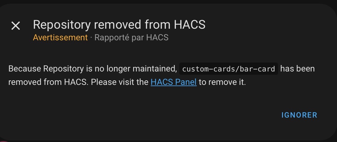

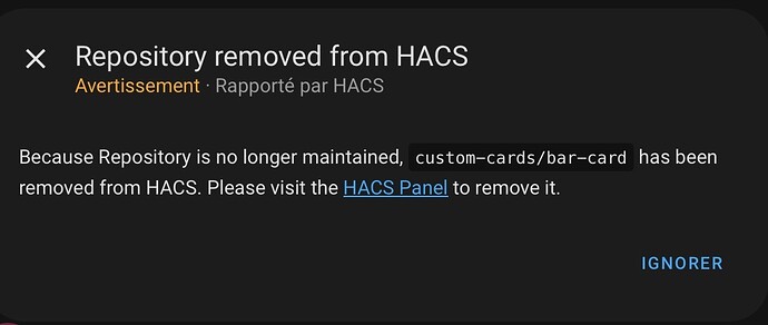

Strange message this morning following a reboot of Ha.
Yeah… that doesn’t seem right. :thinking:

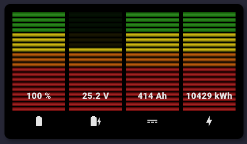

Hi, not sure if you still trying this, see below that is currently working for me
columns: 1
decimal: 0
positions:
  icon: outside
  minmax: 'off'
  indicator: 'off'
direction: right
height: 60px
entities:
  - entity: sensor.huidige_battery_soc
card_mod:
  style: |
    ha-card {
      background: black !important;
    } bar-card-background bar-card-backgroundbar {
      background: linear-gradient(90deg, #B22222 0%, #B22222 5%, #CF5B00 30%, #E6BB00 50%, #228B22 100%);
      mask-image: repeating-linear-gradient( 90deg,  rgba(0, 0, 0, 0.3) 0%, black 2%, rgba(0, 0, 0, 0.3) 4%, transparent 4%, transparent 5%);
      border-radius: 0px;
      opacity: 0.35;
    } bar-card-background bar-card-currentbar {
      border-radius: 0px;
    } bar-card-value {
      margin: 20px;
      font-size: 1.25rem;
      font-weight: 800;
Same here. I ignored it to keep it working.
