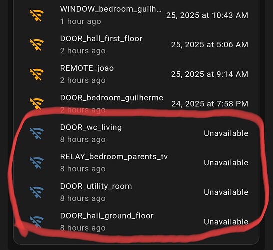

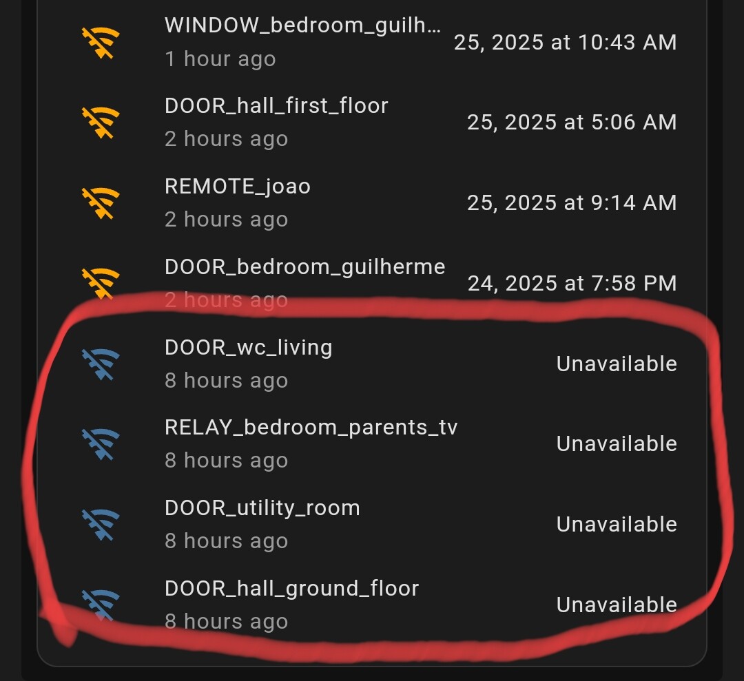

I can’t see any entity this way. I only want to see the ones that are unavailable.

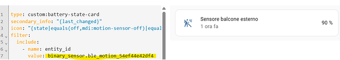

Dear all, I want use this card for see the motion sensors sort for detection, but for the motion sensor model RTCGQ02LM, I don’t see the state but the battery percentage.
Can somebody help me?
thanks.

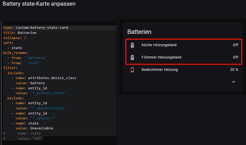

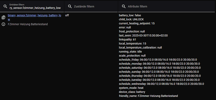

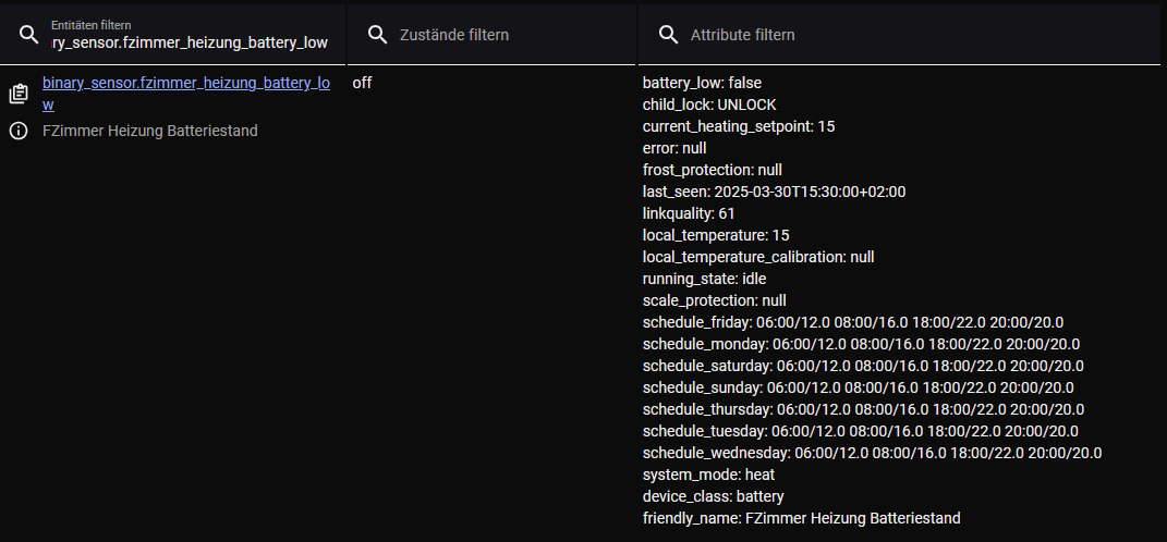

I want to integrate Zigbee valves with the battery state ā€œonā€ for low battery. But I can’t get it to work because the card shows ā€œoffā€ for normal. It has to be inverted.
Here is the entity overview for ā€œlow-batteryā€ of AVATTO ME167:
thanks and greeting

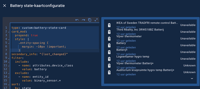

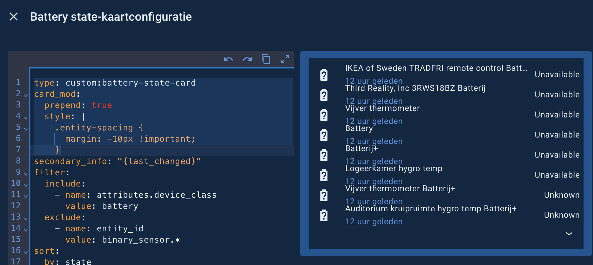

You could try using prepend: true to your card_mod config. Looking at the battery-state-card code, I am not sure how long it takes to generate the list. If it has nothing to show it does not include a card, which may mean that card_mod gets removed when the card is finally shown.
card_mod:
  prepend: true
  style: |
next to that, it requires !important
tbh, not sure why you would want to do that, as it is very ugly, and the name touches the secondary info.
other than that, it works

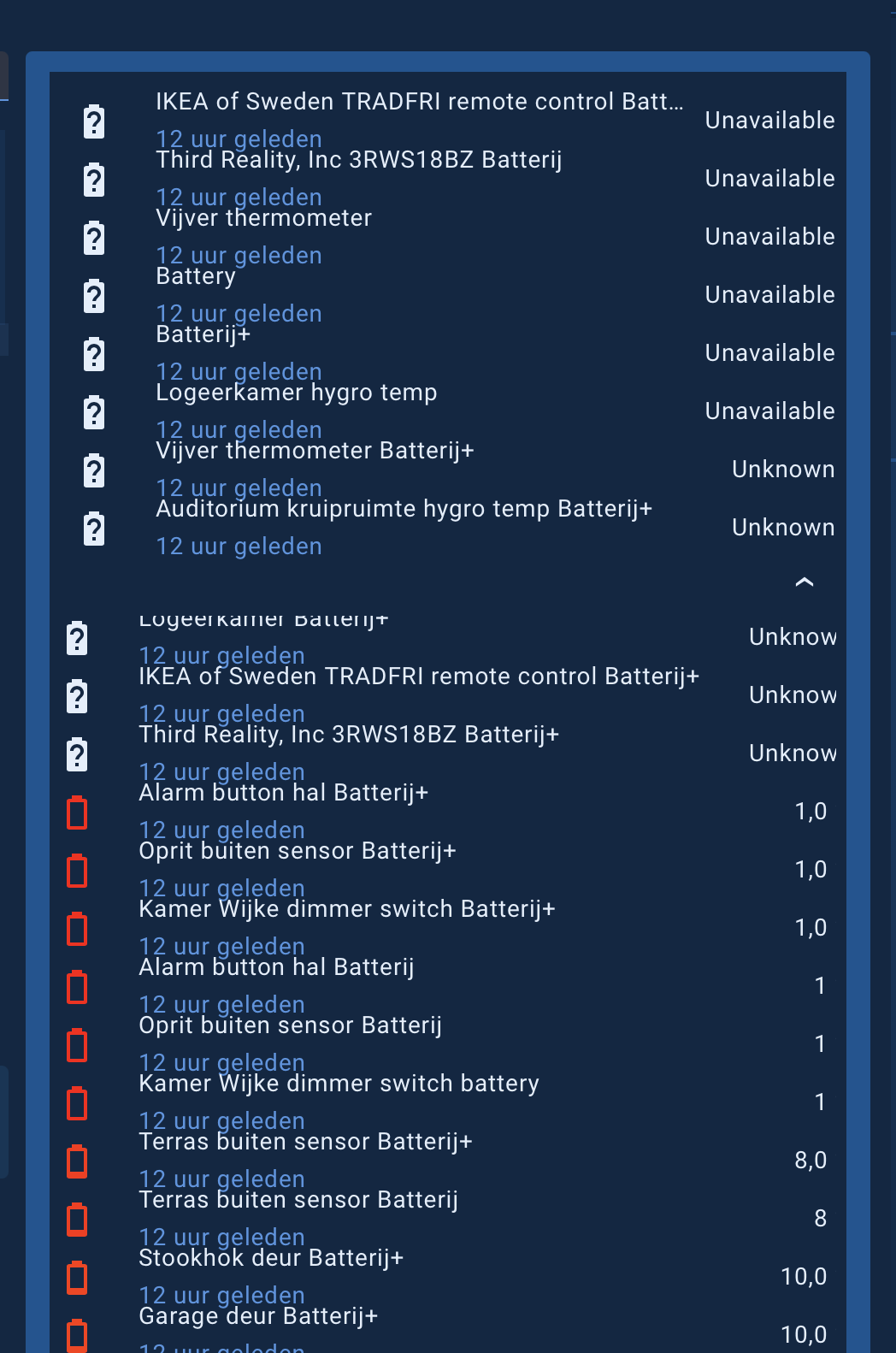

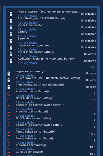

type: custom:battery-state-card
card_mod:
  prepend: true
  style: |
    .entity-spacing {
      margin: -10px !important;
Thanks, the prepend works. @Marius: I am doing this since I am not using secondary info in this case, and then the spacing is (for me) much too large.
Thanks for the update. I have updated v4.0.0 BREAKING CHANGES - Check here first Ā· Issue #498 Ā· thomasloven/lovelace-card-mod Ā· GitHub to list custom:battery-state-card under the prepend section.
note: in my config it required the !important to make the margin modifications get applied.
other than that I also see a warning on the card itself.
SchermĀ­afbeelding 2025-11-23 om 22.10.36
not using the card itself, I wont pursue here, but might be an issue worth raising in that repo

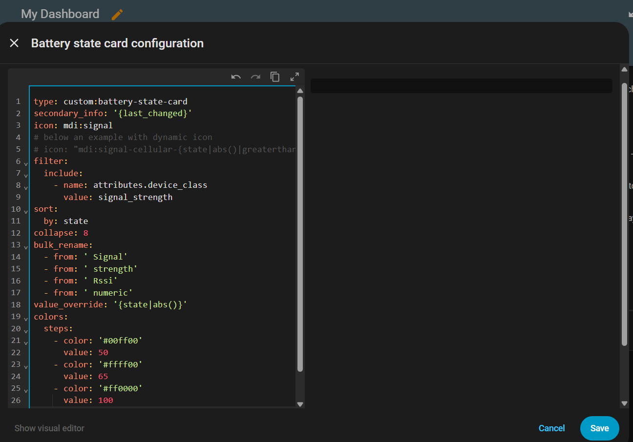

First off, I’d like to thank you for battery state card! After migrating from Hubitat to HA about 2 months ago, I’ve looked at several battery monitoring solutions. Most had numerous options I’d never use. This is straightforward and brilliant!
Now for my question – I’m trying to add your card and configure it using the signal strength YAML. But when I paste it as you can see there is nothing displayed to the right of the YAML. When I save the card there is nothing shown but an edit button. I’m using HA 2025.12.0.
-Thanks
