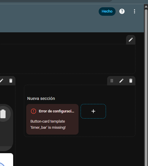

Sorry, but I still don’t understand where to put the templates
Is that where the 3 dots are? I go there, paste the template, and it still can’t find it.
You are missing button_card_templates which is the parent config dictionary.
So…

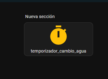

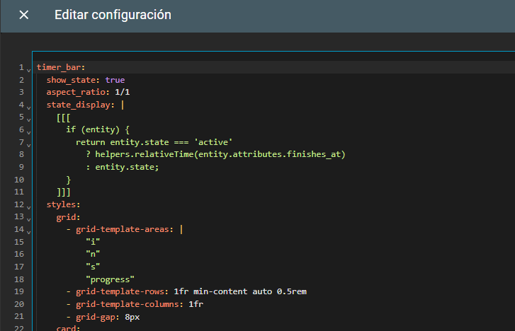

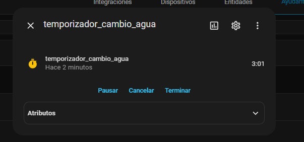

The timer is running but the progress bar is not visible.
Now it seems that it accepts the template but something is not right with it.
Post your config (not picture use code insert backticks).
