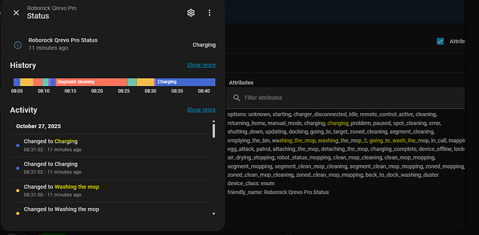

Guys, how to use the state_translated for an label for example?
this works:
- label: "[[[return `${states['sensor.roborock_qrevo_pro_status'].state}`]]]"
But this doesnt:
 - label: "[[[return `${state_translated['sensor.roborock_qrevo_pro_status'].state}`]]]"
i get this error:
button-card.js:482 ButtonCardJSTemplateError: state_translated is not defined
I wanto to use the more reabable state of a sensor like the ones below:

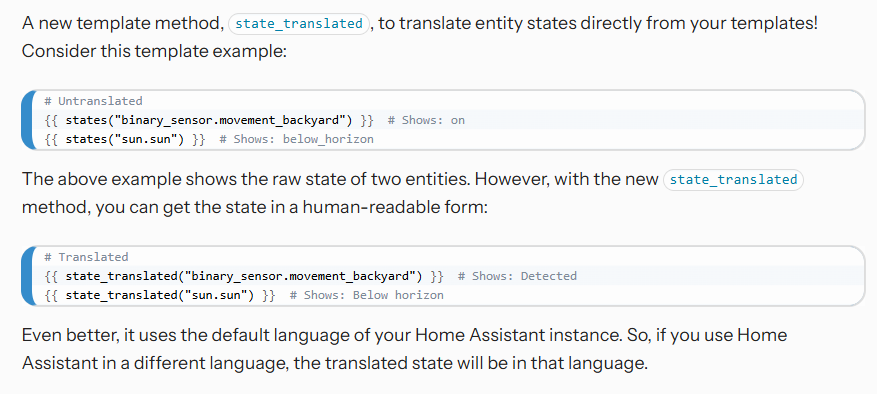

as in docs here:
Did you check in template editor of the developer tools if it’s working there?
Does anybody know, if _translated is available for state_attr also, e.g.
{{ state_attr(‘climate.ecobee’, ‘preset_mode’) }}
The object state_translated doesn’t exist in custom button, instead use helpers.localize, e.g.:
- label: "[[[return `${helpers.localize(states['sensor.roborock_qrevo_pro_status'].state)}`]]]"
Read here
take out the .state
- label: "[[[ return ${helpers.localize(states[‘sensor.roborock_qrevo_pro_status’])}]]]"
you can probably also do without the ${} and do
- label: "[[[ return helpers.localize(states['sensor.roborock_qrevo_pro_status']) ]]]"
