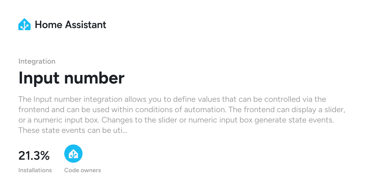

I was using text because I thought input_number required the slider, I wanted to be able to specify a number.
nope.
