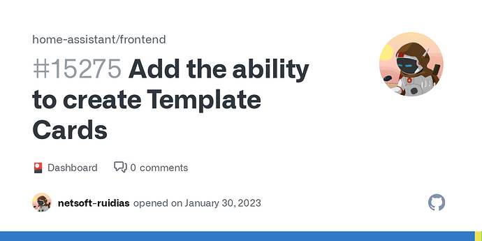

Take a look at this, if you agree give it a thumbs up

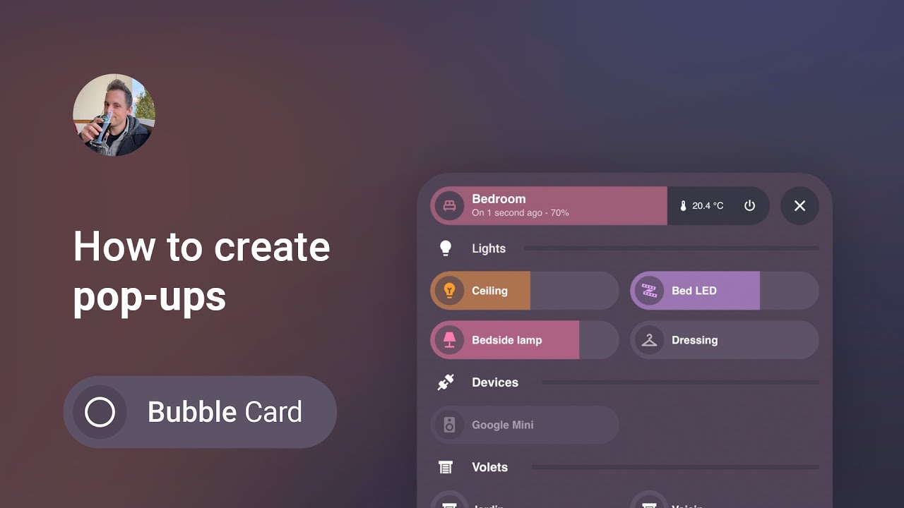

Maybe I am missing something, where is the button card that uses navigate to actually open the popup?
Note the second part in this video, first makes what’s 9in the popup … if you view then the page is empty (as expected). Then he adds a bubble card at the top of /before the popup that will open and close the popup.
