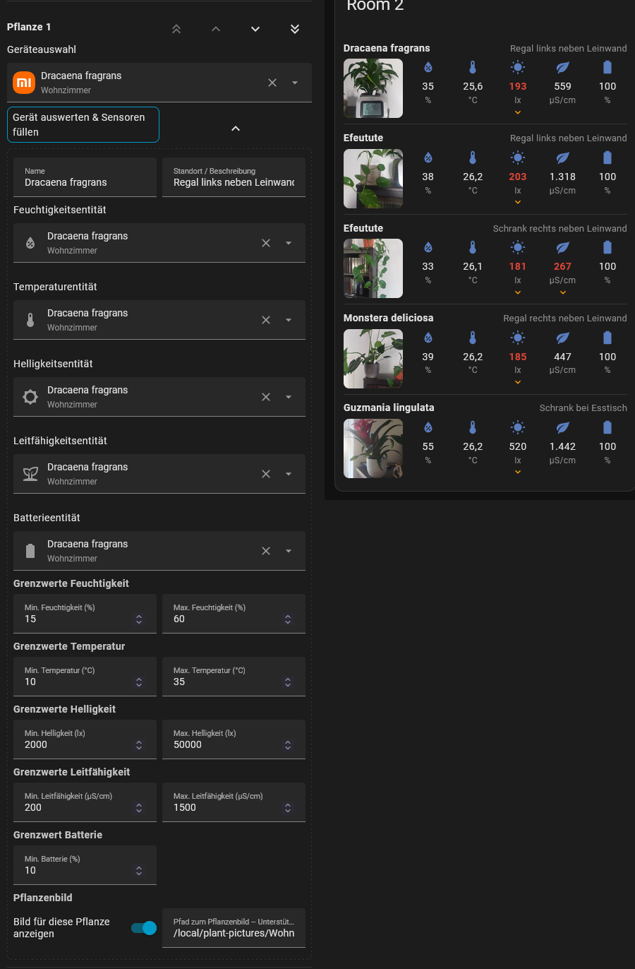

Hey Guys,
since I couldn’t find a suitible flower card for my needs I created my own with a little help by ChatGPT.
It’s designed based on the HA plant card.
It’s designed to accomodate as many flowers in one card as you like, have a little optional preview picture, you can define your upper and lower borders for your sensors directly in the card without any need for additional configuration in any .yaml, these are shown via red color of the entity and additional chevrons and is completely configurable in the GUI.
Features
  • Manage multiple plants in a single card
  • Device selection with automatic entity mapping
  • Adjustable thresholds for:
    • Moisture
    • Temperature
    • Illuminance
    • Conductivity
    • Battery
  • Optional plant images with click-to-enlarge lightbox
  • Per-plant toggle for image visibility
  • Automatic default image path generation based on device, location, and area
  • Click on values to open entity more-info
  • Configurable icon colors
  • Compact, responsive design for desktop and mobile
  • Fully localizable (English and German included)
Please have a look and let me know what you think.
As of now it shoul support English and German but I only tested the German version.
It’s designed to easily add more languages.
I hope you like it, enjoy!

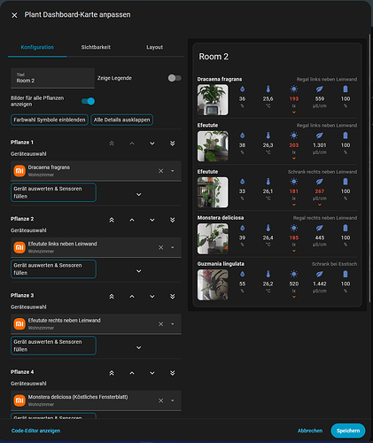

here are additional screenshots, since I couldn’t include them into the original post as a new member
