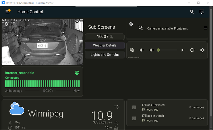

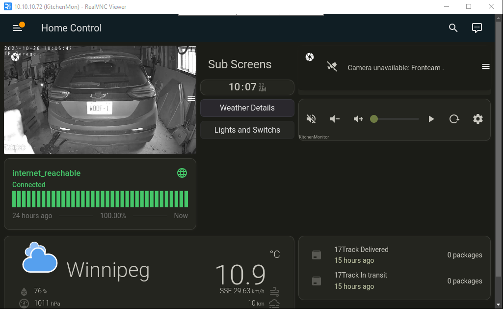

I have a lovelace screen up running as sort of a kiosk. On it I have two images coming from Frigate. The problem I am having is the images seem to vanish with an error message.
Some times both images are displayed, some times one or the other (changes which one constantly) some times neither image shows up.
Does anyone else have this problem? Is there a fix for the problem? Am I just doing something monumentally wrong? (Seriously still a NOOB so any critique of my methods are OK)
Greg

Over the last few hours the right hand image reappeared. Nothing was done to the dashboard to cause it to reappear, did it on its own. Very confusing.
No one is having a problem like this? Can not believe I am unique in this. Is it possible I am doing something fundamentally wrong here?
Is there a better way to display the image from a camera on a kiosk screen? I could be just using the wrong card type.
Just frustrating having it ‘almost’ working. Just the one time you want to look at the images, there is nothing there to see.
Greg
