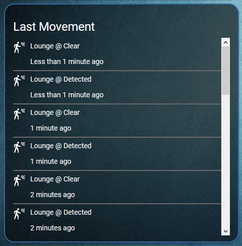

However I only want it to show movement, not the return to clear state. I’ve tried all of these without success:
  - entity: binary_sensor.pir_lounge
    icon: 'mdi:motion-sensor'
    include_history: true
    max_history: 20
    remove_repeats: false
    exclude_states: Clear
    max_history: 20
    exclude_states: clear
    max_history: 20
    exclude_states: 'off'
Am I doing something wrong or is this a bug?
The dev tools states menu reports the PIRs states as off when clear.
The ‘Clear’ state was in quotes but lovelace removed them
Also I dont suppose I can use wildcards like this?
  - entity: binary_sensor.pir_*
    max_history: 20
It would considerable shorten that card config.

Unfortunately this config:
    content_template: '{{display_name}} Movement {{state}}'
    max_history: 20
    exclude_states:
      - 'off'
Still results in:
Annotation%202019-08-16%20223409
Can you confirm what version you are using?
The exclude_states option was added in the 0.2.9b1 beta version. If you use HACS you will need to select “Show beta” on the “hamburger” menu on the card details to see the beta versions. Otherwise you can download the betas from the releases page page on the repository.
Yep that’s the issue. I’m not on the beta version, apologies.
Thanks. I’ll upgrade now.
Yikes! I upgraded to the beta version and did a force refresh of the page and got a nasty red Custom element doesn't exist: home-feed-card.
I didn’t notice that the resource had changed.
Fixed that and it is working as expected. Thank you.

It also looks like the issue is partly related to the the sensitivity of the specific sensors and how often they are switching between Detected and Clear. Could these be smoothed out it any way, such as using a template binary sensor?
It may be possible to have an option in the card which filters out states which repeat within a period of time (e.g. if it changes to Detected, then Clear, then Detected within a 5 minute period) but this would be quite complicated to implement.
Yes it does:
Annotation%202019-08-18%20004612
card:
  id_filter: ^home_feed_.*
  max_item_count: 20
  show_empty: true
  style: |
    ha-card {
      border: solid 2px var(--primary-color);
  title: Last Movement
  type: 'custom:home-feed-card'
filter:
  include:
    - entity_id: binary_sensor.pir_*
      options:
        max_history: 20
        remove_repeats: true
type: 'custom:auto-entities'
That’s the problem. It wasnt. It was removing every trace of an entity that had a duplicate entry in the feed. Now it’s not removing anything though.
They are wired PIRs. They come on for 3sec. minimum. Pretty smooth. No bouncing contacts, that’s just me waving my arms in front of the sensor repeatedly to test for duplicates.
I think max_item_count (which you have set to 20) may be the cause of this issue. Since the processing of remove_repeats happens before applying the max_item_count (which was a newer feature) the earliest Detected event for that entity may have not have been one of the 20 most recent events and been cut off. Can you try with the previous beta, but without that option set (or with it set to a higher value) and see if that is the cause of your issue?
If it is, I don’t know the best way to deal with that (other than potentially an option to control how much of the history to use, so you could just display the last 6 or 12 hourse, for example).
