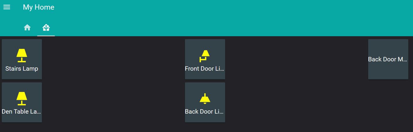

There are multiple tabs so I have a horizontal-stack for each of the 2nd and 3rd tabs (i.e. views).
Even so, should it not show the cards horizontally? Currently they are stacked vertically
Do you have 3 tabs now? Can you show a picture how it looks like currently? I will need to check your config when I’m home again.
Here is how it looks now…
Ok… I made a few changes to my config and sorta have the cards arranged horizontally. What I don’t understand is why it shows 2 cards per line

You need to put the horizontal stack one level deeper. Currently you are defining the view as horizontal stack but instead the first card of the view should be the horizontal stack.
Try this:

Ok, I know have my cards aligned horizontally but not all of them are showing. How do I control the “window” of the cards?
