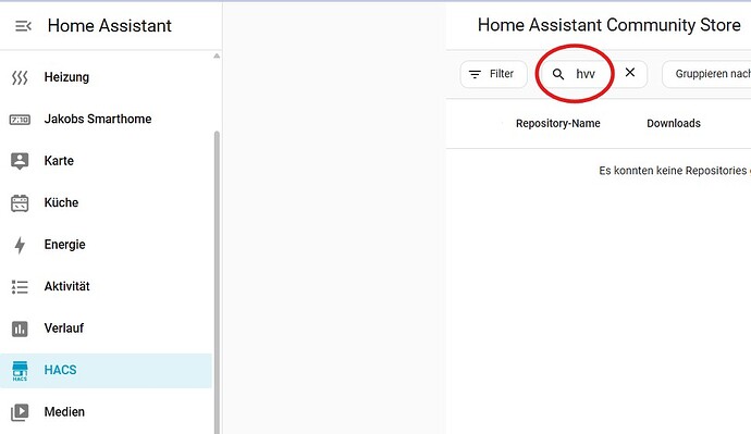

Is this hvv card still maintained?
It is not available in HACS (my HACS is not showing any filter result with HVV), but Github proposed installation method is via HACS.
Regards

Hi @Liese , I try my best to maintain it, next to my job and family. I’m open to contribution though, and haven’t seen a HACS issue so far. Any idea what the problem might be?
I will try again tonight.
It just does not appear in HACS on my installation by using HVV to filter the available integrations.
I am more an end user, but do my best to work into these programming details…
Maybe fault is on my side…
@Liese , others, there was indeed an issues with the HACS config that affected new installations. I fixed it.
You should be able to get version 0.5.0 via HACS install or update. This includes some usability improvements, including a visual editor, improved sorting, and enhanced error handling.
See Releases · nilstgmd/hvv-card · GitHub for the full list
Let me know if this works for you.
OK, too long ago, that I have configured my HA.
By adding a custom repository via link, it says it is already present and it shows up.
Somehow strange…
Works now! Thanks!
