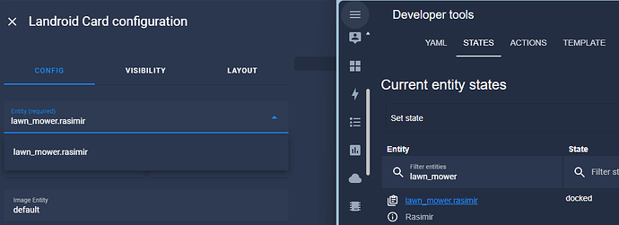

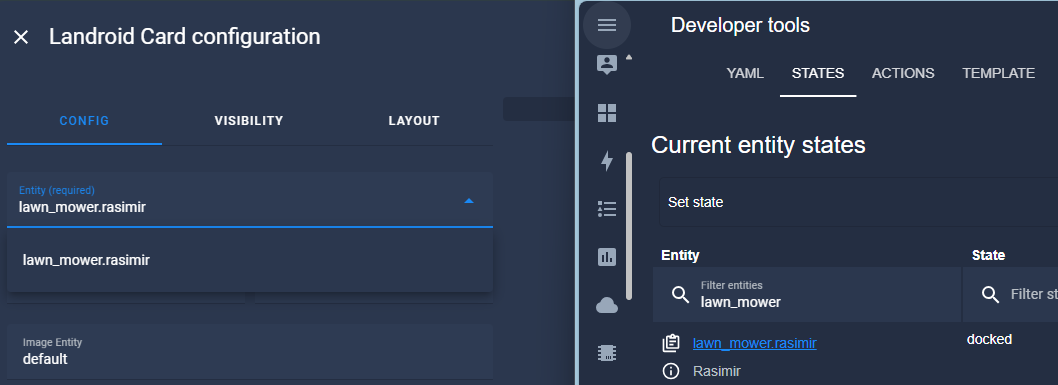

Change entity in the card configuration
Thanks for replying so quickly! Unfortunately, there is only one entity, and this is the one that is selected:
Please publish card config here

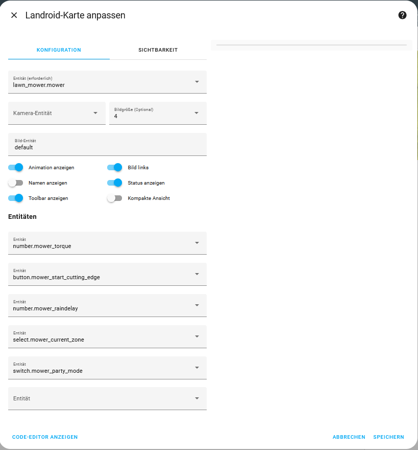

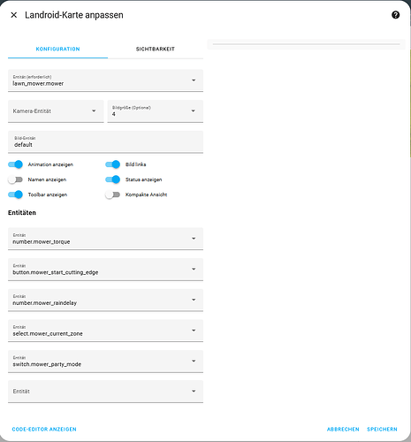

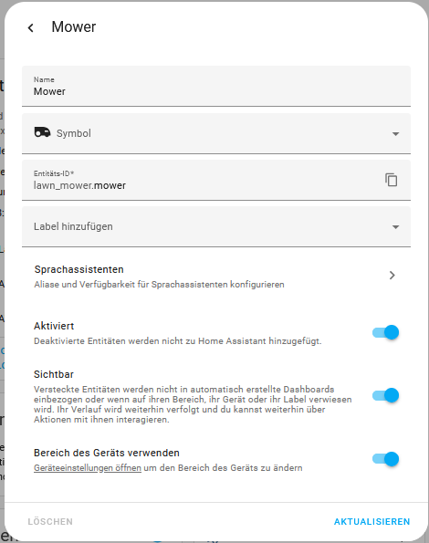

I have the same issue. My Landroid card remains empty … This is my card configuration:
image: default
image_size: "4"
show_animation: true
show_status: true
show_toolbar: true
type: custom:landroid-card
entity: lawn_mower.mower
show_name: false
image_left: true
compact_view: false
settings:
  - number.mower_torque
  - button.mower_start_cutting_edge
  - number.mower_raindelay
  - select.mower_current_zone
  - switch.mower_party_mode
But card remains empty:
The mower itself is available:
Fixed it by reinstallation of landroid cloud integration…

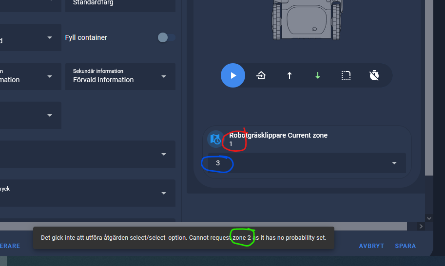

I am having issues setting Current zone, choosing Current zone from the dropdown on the Landroid device page shows this error:
select/select.option Cannot request zone 2 as it has no probability set.
Zone 2 is available, and the weird thing is that my script sets the zone to 2, but the error says zone 2.
How do I manage to do this?
Check this screenshot (in red is the current value, in blue what I selected, and in green what the error shows, the value stays unchanged as 1):
What is if you select zone 1?
Do not set 0% probability for a zone, this will result in what you describe
