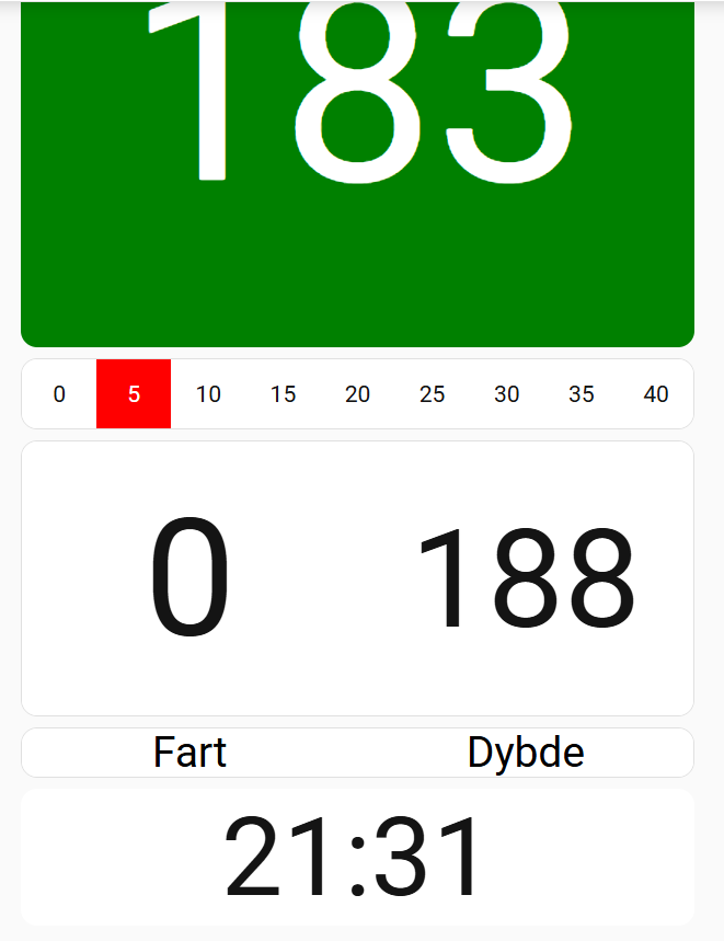

I have this that is almost the way I want it:
But I would like to move 0/188 and Fart/Dybde close to each other, and preferably get rid of all the frames. This is the code I have:

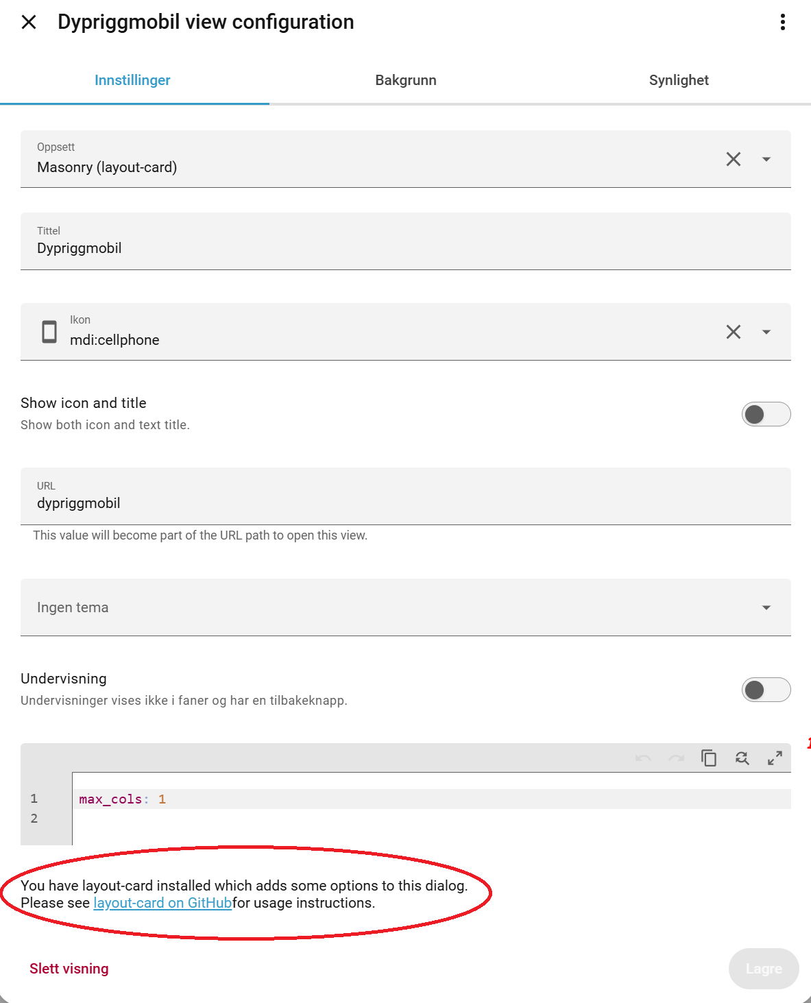

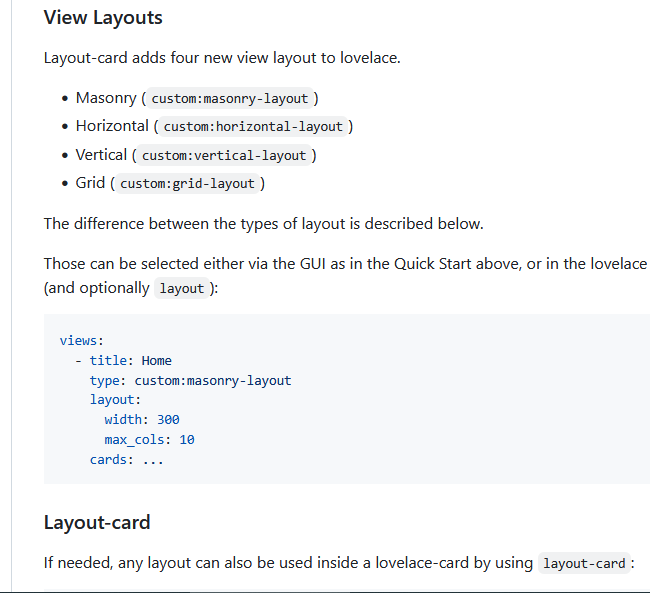

For Your information, You are Not Using any Layout-Card, But a masonry-Layout-View
( Most likely with 1 column ? ), with ( first ) a single button-card and then a few vertical-stack-in-cards, with button-cards inside.
So you need to “address” each in different levels
As i for good reasons never used Masonry-Layout-View, i can’t post any examples

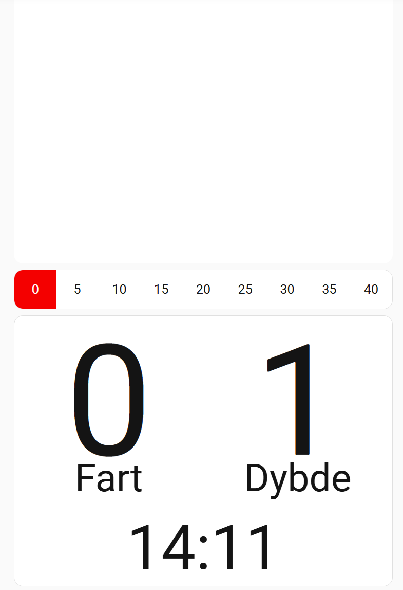

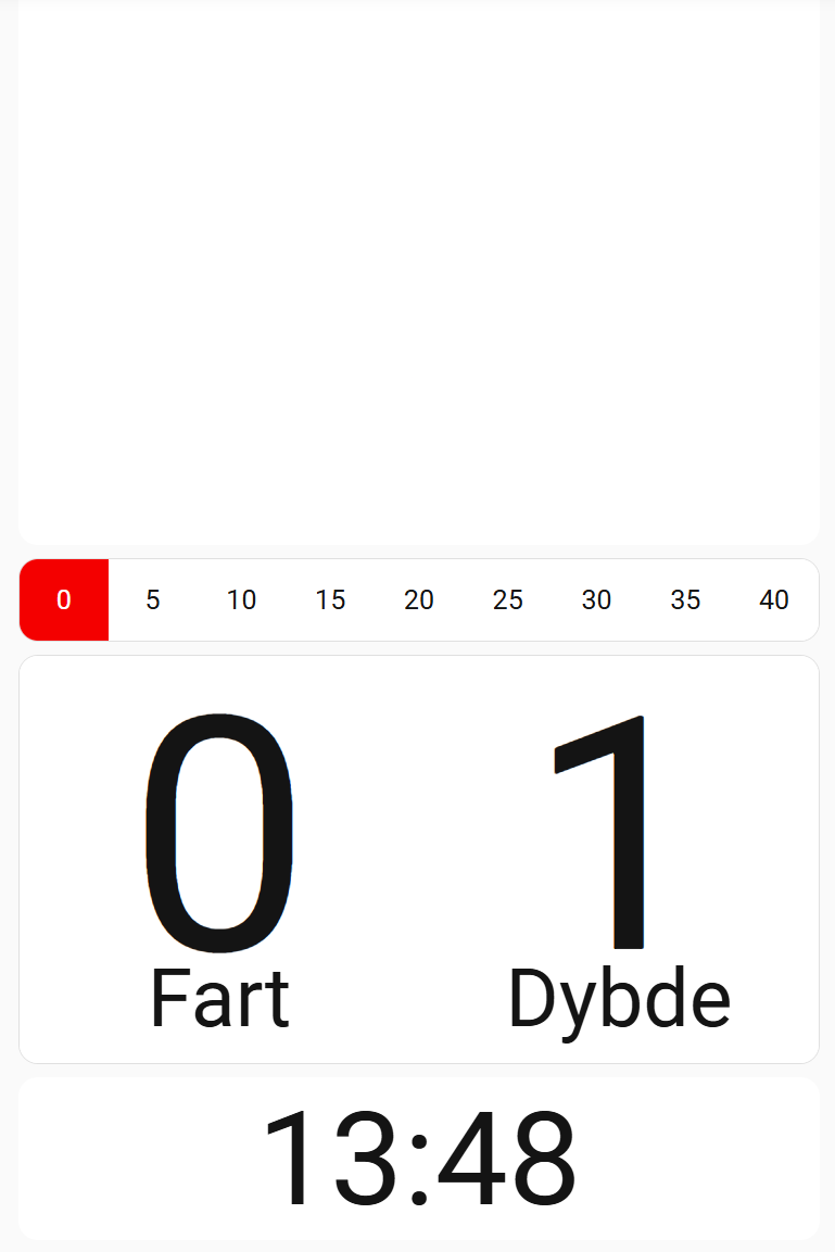

Alignment of the 2 ( fart dybde ) can be addressed in different ways
i.e , under type custom:button-card ( after styles ) (addressing the :host )
        uix:
          style: |
            :host {
              **border: none;**
              max-height: 60px;
              max-width: 120px;
              margin-top: -35px !important;
              **margin-left: 30px !important;**( for fart ) VS **margin-right: 30px !important;**(for dybde)
              padding: 0% !important;

Thanks for answering! I was so sure that type: custom:masonry-layout meant that I was using the lovelace-layout-card, it says so in the settings for the dashboard:
And I wasn’t clear enough, I guess. I wasn’t talking about the fields Fart and Dybde togheter, I meant 0 and Fart together and 188 and Dybde together, so vertically. The uix code did not work, maybe the best would be to remake it as a custom button card with custom fields, I’ll look at that this evening.
Basically i don’t see the reason to create 2 new cards just to give the above a " - name "
Thats what button-card are made for, i.e place - name field under the State filed
This is a custom layout card for sure.
Call it what You want
Do You notice the different , and Mastiff View ?
However Yes Thomas call the integration Lovelace-layout-card
But with Masonry-view and 1 column ?, there is no need for this “integration” at all, as he could have used a Panel-View, with vertical-stack “Masonry-view has no effect with 1-Column”
I am getting closer by using a second custom field in the custom button card. I think this is probably as good as I need it:
type: custom:button-card
variables:
  stor_skrift: 200px
  liten_skrift: 180px
  dyp: '[[[ return states[''sensor.dybde'']?.state; ]]]'
custom_fields:
  dybde: |
      return `<span style="align: center;">${Math.round(states['sensor.dybde'].state) } </span>`
  dybdenavn: |
      return `<span style="align: center; font-size: 50px; line-height: 0.">Dybde </span>`
show_icon: false
show_name: false
styles:
  card:
    - height: 250px
    - border-style: none
  grid:
    - grid-template-areas: '"dybde" "dybdenavn"'
    - grid-template-columns: 1fr
  custom_fields:
    dybde:
      - font-size: >
          [[[ if (variables.dyp > 100) return variables.liten_skrift; if
          (variables.dyp < 100) return variables.stor_skrift; ]]]
    dybdenavn:
      - padding: 0% !important;
        margin-top: -30px !important;
I think I will try to put the clock inside the same custom button so I can get rid of the border between that Fart/Dybde. I just need to read a bit more of the documentation, so I can see how have 0/fart and 1/Dybde on one line and the clock on the next line. Or maybe just use a stack-in card in a stack-in card, with the first being vertical, and the one inside being the horizontal with Fart and Dybde.
And that finally worked with card_mod:
type: custom:vertical-stack-in-card
cards:
  - type: custom:vertical-stack-in-card
    card_mod:
      style: |
        :host {
          --stack-card-margin: 0px;
          --ha-card-border-radius: 12px;
          --ha-card-border-width: 0px;
    cards:
      - type: custom:button-card
        custom_fields:
          fart: |
              return `<span style="align: center; line-height: 0.">${ Math.round(states['sensor.fart'].state) } </span>`
          fartnavn: |
              return `<span style="align: center; font-size: 50px; line-height: 0.">Fart </span>`
        show_icon: false
        show_name: false
        styles:
          card:
            - height: 250px
            - border: none
          grid:
            - grid-template-areas: '"fart" "fartnavn"'
          custom_fields:
            fart:
              - font-size: 200px
            fartnavn:
        variables:
          stor_skrift: 200px
          liten_skrift: 180px
        custom_fields:
          dybde: |
          dybdenavn: |
        show_icon: false
        show_name: false
        styles:
          card:
            - height: 250px
          grid:
          custom_fields:
            dybde:
              - font-size: >
            dybdenavn:
    horizontal: true
    custom_fields:
      klokke: |
          return `<span style="align: center; font-size: 80px">${states['sensor.time'].state}</span>`
    show_icon: false
    show_name: false
    styles:
      card:
        - height: 100px
      grid:
        - grid-template-areas: '"klokke"'
For that you need to address the GAP , it’s not “borders !”
Either Gap, or you could i.e use margin-top: -20px , on the clock card ( That is if you have "removed the “borders”, otherwise it will look odd
But yes you can have as many fields you want in custom:button-card( using the grid for what it’s for ), You could also just use 1 of the “Default-Fields” , i believe there is a pic in the docs how the default card is build up, as well as how to use the grid-feature
