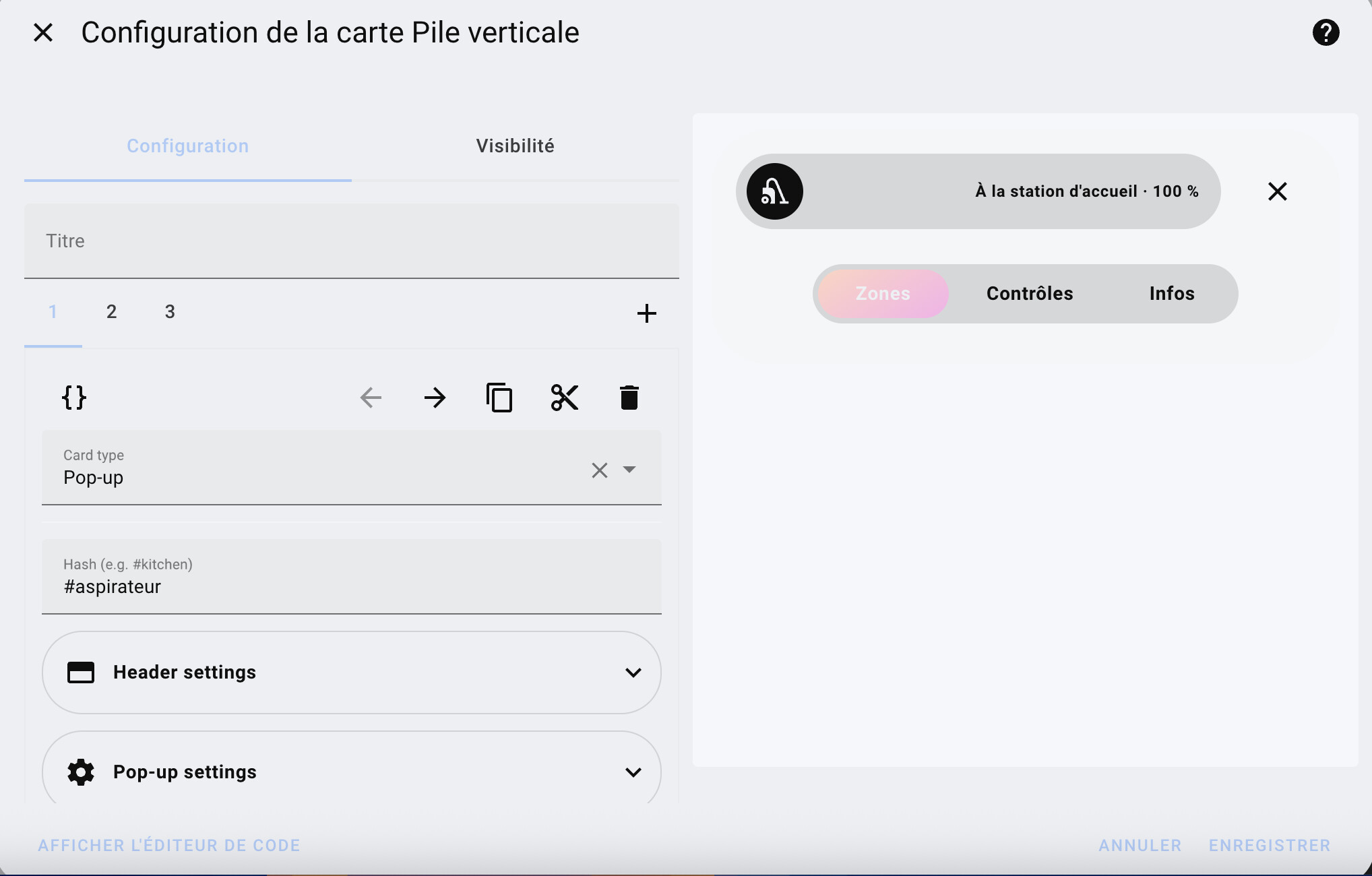

Anyone else having problems when HA updated to 2025.5?
The tabs are not showing in the editor, so I cant visually edit the cards anymore (I cant choose Cards).
Luckily there are no issues with the functionality of the card.
Hello @PaNiCo
I have exactly same problem, i hope @3_14 fix the problem
I also have the same problem where I can only edit the cards with the code editor. I thought I was going crazy because I didn’t see the other editor anymore. Is it possible that there will be a fix?

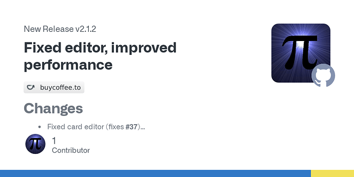

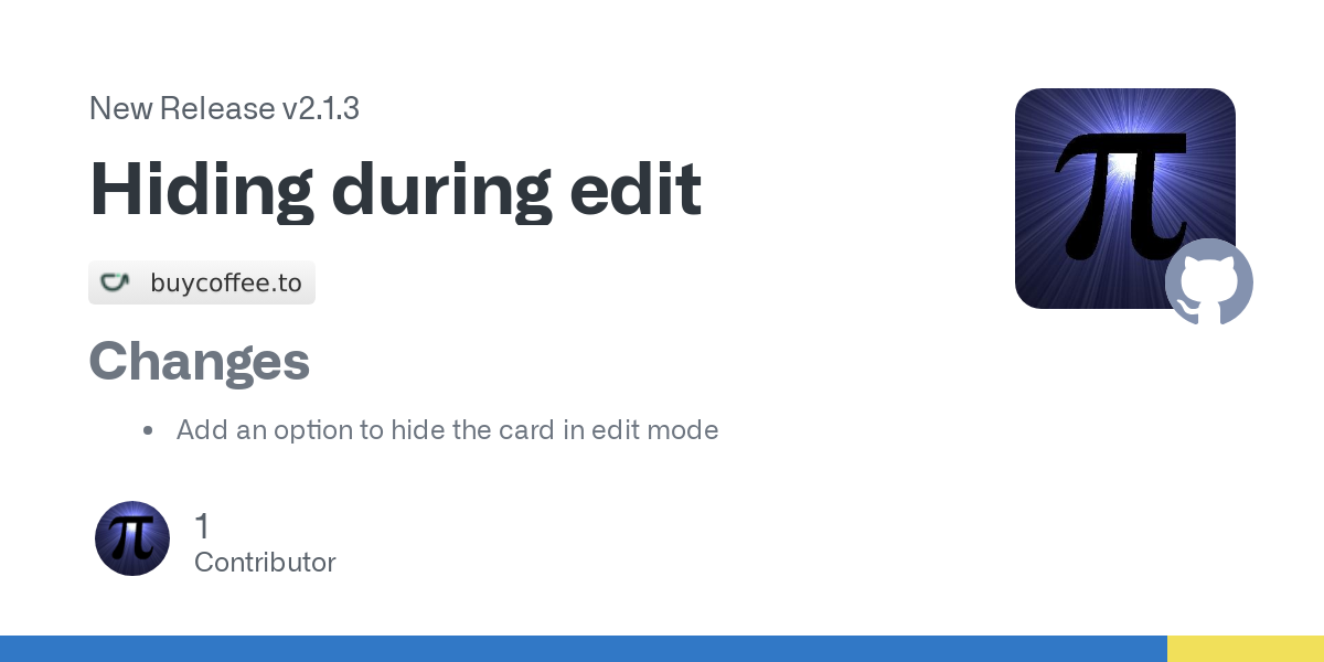

New release: v2.1.2
Fixed card editor, drastically improved performance, removed empty spaces.

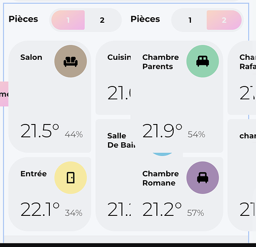

Hello @3_14

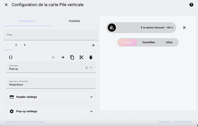

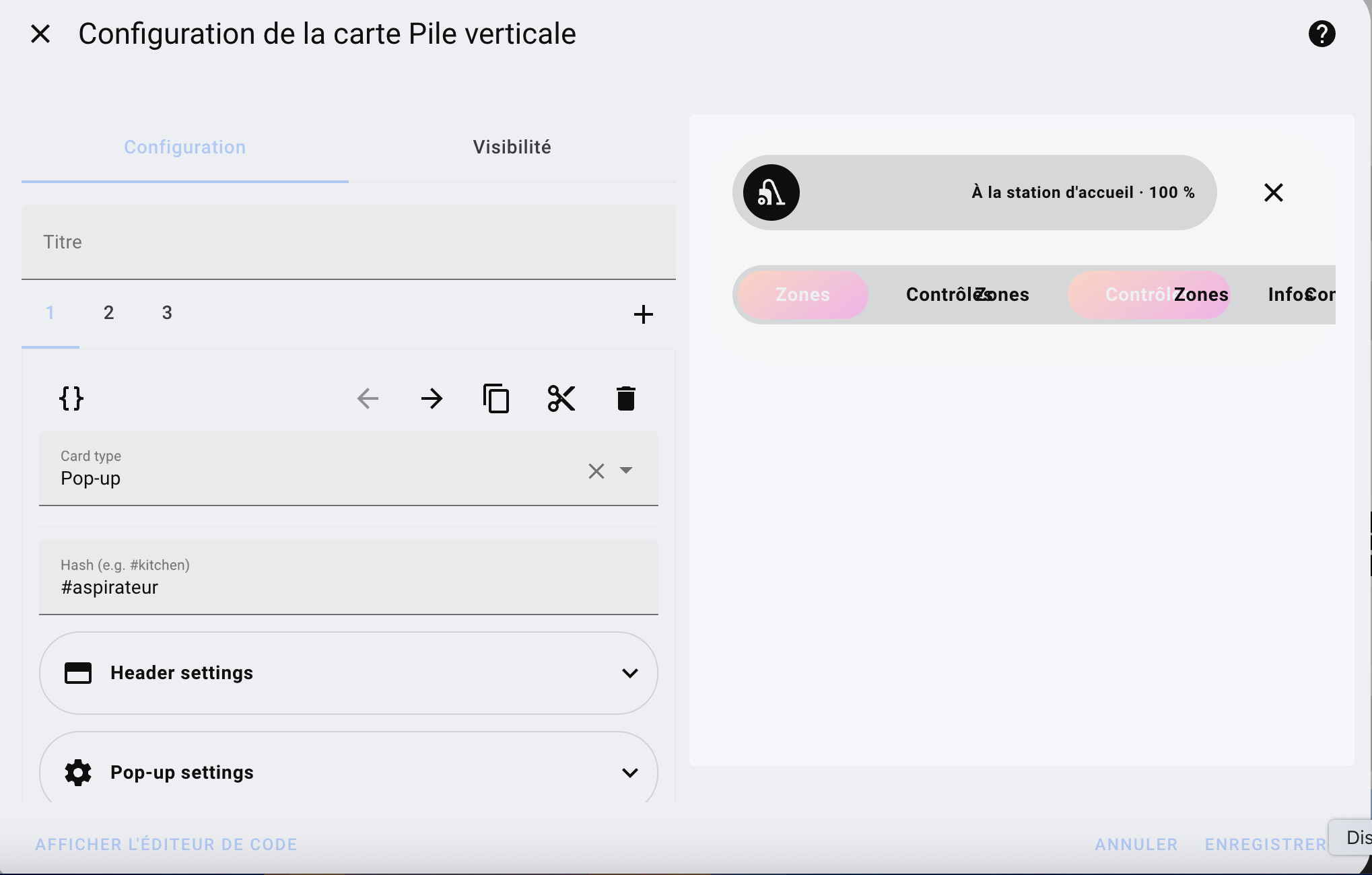

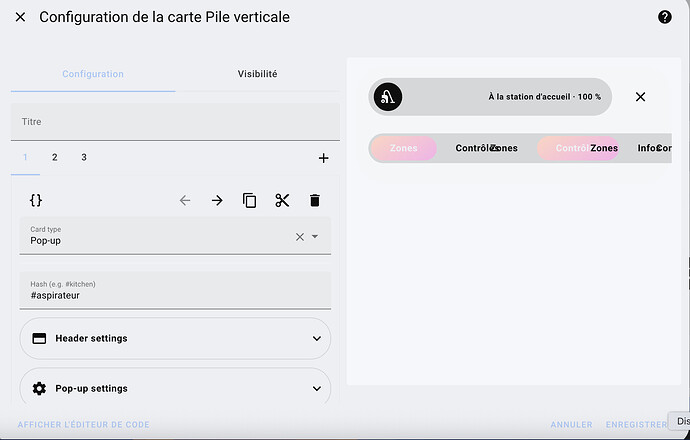

THX for update but i have a problem.
All conditional cards are displayed at the same time when editing
With 2.1.2
With 2.1.1
I clear cache and reboot HA but nothing change :neutral_face:
This is intentional, to behave the same way as built-in “normal” conditional card.
ok thx @3_14

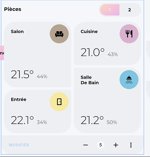

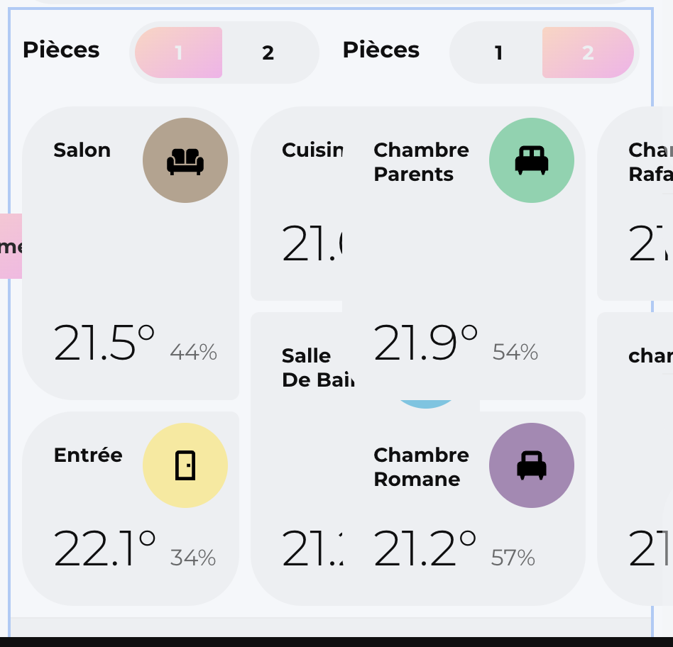

I must admit I find this visually confusing.
How can I improve the display in edit mode? I don’t have a large screen to display everything.
It would be super cool to be able to choose the display mode :grinning:
Yeah, it is a bit confusing in your case.
Here you go:
your the best big THX @3_14 work great
