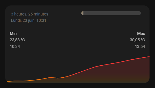

Something that has been asked many times in the requests section on github is the ability to dynamically change hours_to_show.
My dashboard became cluttered with conditional cards to show different timelines for each sensor using input_select helpers. A nightmare.
Well. I went ahead and asked Claude (3.7 Sonnet) to add that options to the code. I can now use an input_number, for instance, to control the graph timeline in real time.
It took me (us!) about 2 hours. I have absolutely no knowledge of JavaScript, Claude did all the work.
Here’s a working version:
Next, I’ll ask Claude to add templating to hours_to_show.
Next time ask AI about “please give me a code as well, not just a picture”.
I have seen code plenty today, don’t worry. I assure you it’s there.
If @kalkih is ok with it, I’ll share the. js file

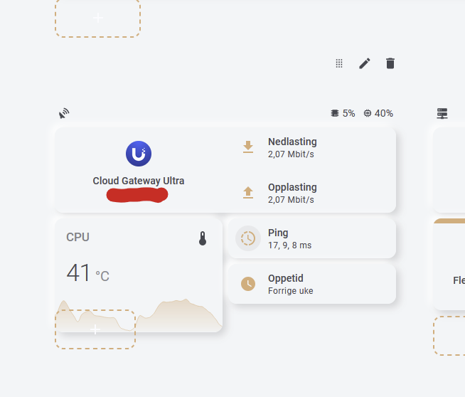

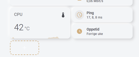

anyone here have any tips on getting the card to respect grid_options?
example here with:
grid_options:
  columns: 6
  rows: 2
Its supposed to align with the “Oppetid” card
Adding this basically hides the graph
card_mod:
  style: |
    :host {
      height: 100%;
You are trying to squeeze a card into a small space.
So, set a bigger “rows” value (along with “100%” card-modding).
Or play with fonts.

For those interested, here’s the modified version to use an input_number in hours_to_show instead of a static number.
The card is called Mini Graph Card (Dynamic) in Lovelace.
The only difference if your yaml code are these two lines:
type: custom:mini-graph-card-dynamic
hours_to_show: input_number.your_input_number
Download: mini-graph-card-dynamic.js
Installation: Follow mini-graph-card’s manual installation instructions but change the filename accordingly.
