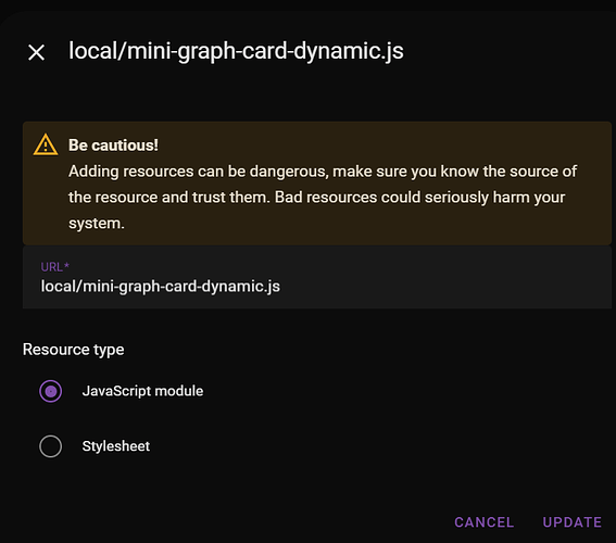

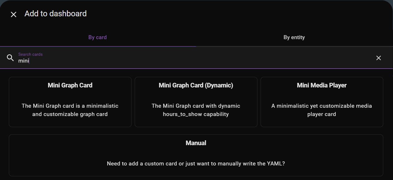

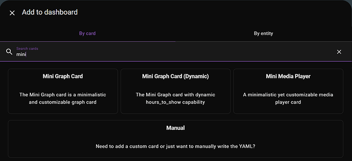

In HA, navigate to Settings > Dashboards
Click on the three dots in the top right corner and hit Reccources
Click on + Add reccources at the bottom right
In the popup window, add this in the URL field: /local/mini-graph-card-dynamic.js
Select JavaScript module
Hit Create
Restart Home Assistant.

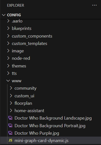

Yes I did that. Downloaded and made a new folder in the community folder for mini-graph-card-dynamic and placed your file in there.
I am considering adding a possibility to use input_number & input_boolean entities for some options like “hours_to_show”, “show::points” etc, but this will not happen very soon.
I’m a bit confused by this bit in your post:
Make a new folder, copy ‘mini-graph-card-bundle.js.gz’ over.
Rename to ‘mini-graph-card-dynamic.js.gz’
mini-graph-card-bundle is the original card, you don’t need it for mini-graph-card-dynamic to work. The only file that’s needed is mini-graph-card-dynamic.js from my other post.
The gz file or anything “bundle” belong to the original card, don’t touch it.
I am a bit confused by this bit. change the filename accordingly?
OK I have copied it directly into the www folder rather than the community folder, seems to work now, thanks.

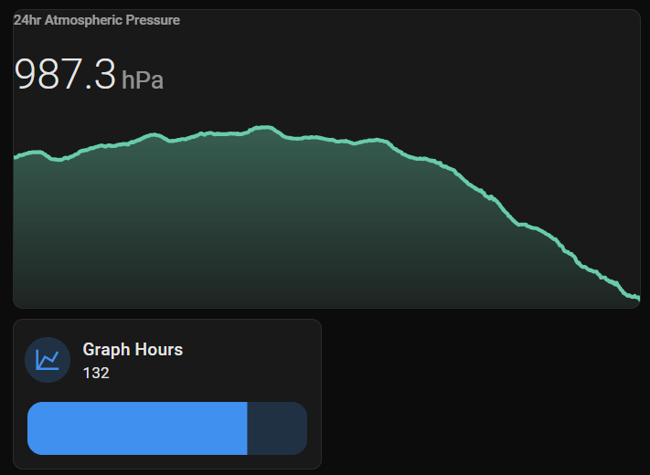

@fauxPalindrome I am not sure what I am doing wrong here but the slider to change the graph hours is not showing up.
I have tried multiple different input_numbers.
I have also tried replacing the following in multiple different cards.
type: custom:mini-graph-card-dynamic
hours_to_show: input_number.graph_hours
name: 24hr Atmospheric Pressure
entities:
  - entity: sensor.netatmo_devonport_tas_indoor_pressure
    color: mediumaquamarine
    show_state: true
    show_indicator: false
show:
  icon: false
  legend: true
  extrema: false
  fill: fade
  labels: hover
  labels_secondary: false
  state: true
font_size_header: 9
align_state: left
hour24: true
animate: true
group: true
smoothing: true
line_width: 3
points_per_hour: 15
height: 150

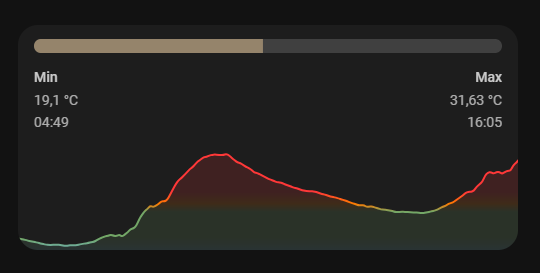

EDIT: It does work with a separate slider control, looked like that was part of the card in your original post. This will be sufficient for my use case, using the one control for all graphs.

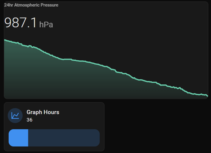

Hi. Same here. I cannot see the slide bar as in original post. Or that is a separate card?
Must be a stack in card or something. Unless there is a show slider option.
Sorry I should have mentioned that I was using stack-in-card, a grid, and some card_mod to change the look of the input_number’s slider in my example, it’s not the mini graph card that’s made like that.
Can you share that card? :smiley:
I have removed the grid and the markdown cards. Here’s the code to get this look:

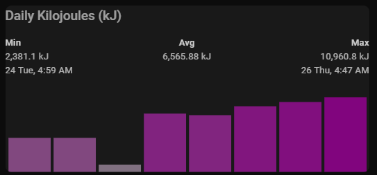

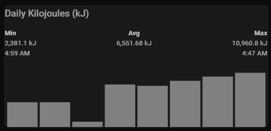

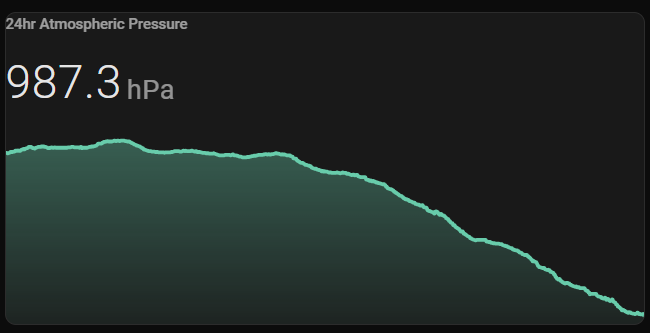

@fauxPalindrome when adding mini-graph-card-dynamic to my mini graph bar charts the colour thresholds do not work for all of my bar graphs.
With mini-graph-card-dynamic
Without mini-graph-card-dynamic
entities:
  - entity: sensor.whoop_andrew_day_kilojoules
    name: Daily Kilojoules (kJ)
show:
  graph: bar
  extrema: true
  average: true
  state: false
  icon: false
limits:
  min: 0
  max: 4000
color_thresholds:
  - value: 4184
    color: gray
  - value: 7531
    color: purple
  - value: 9205
    color: blue
  - value: 11297
    color: limegreen
  - value: 12552
    color: lime
  - value: 16736
    color: gold
font_size: 80
height: 113
points_per_hour: 0.0417
group: true
