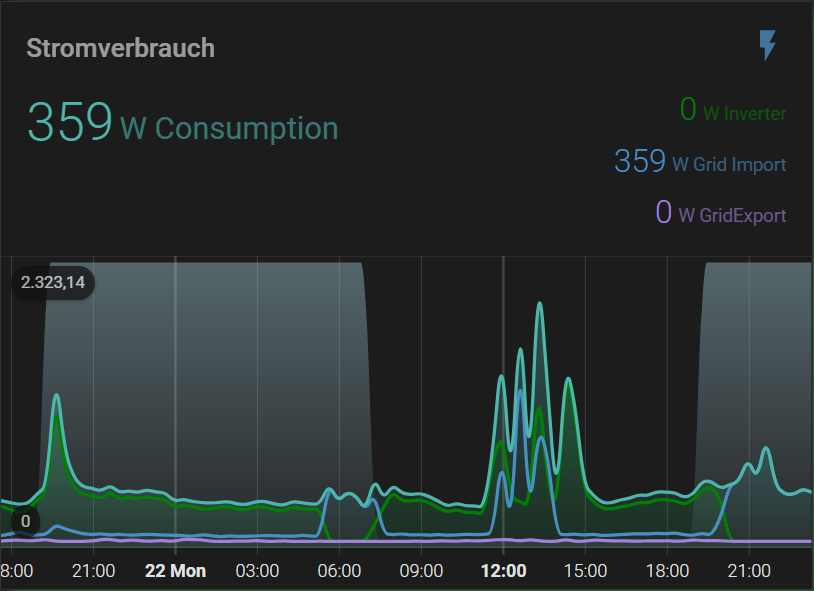

Lovelace: mini graph card
Or you could use a 0/100 sensor read the posts below this link. You basically turn your cooling into a binary sensor 0 when it is off, 100 when it is on. This method effectively gives you a second y axis.
@Ildar_Gabdullin 0/1 senor 0 when it is off, 1 when it is on.

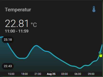

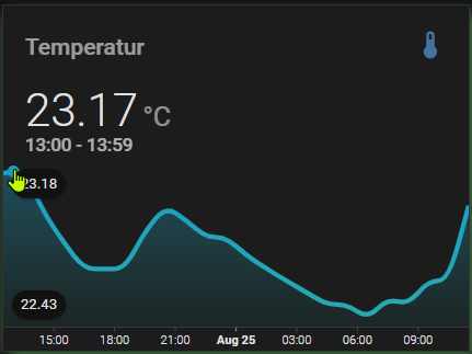

Hi, I’m playing around with labels and gridlines for the x-axis. Does anybody know if there is a reason that one data point is always missing from the time frame (hours_to_show * points_per_hour), at least for the line graph?
Code:
hours_to_show: 24
group_by: hour
Data points in graph:
Start data point: 13:00 - 13:59 (previous day)
End data point: 11:00 - 11:59
Shouldn’t the time start at 12:00 - 12:59 instead of 13:00 - 13:59, spanning an overall time of 24 hours?

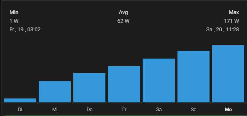

Can I only display a first entity as a graph with no values or extremes and the second entity not as a graph but show the extrema and average values?
I try this, but did not work:

          - type: custom:mini-graph-card
            name: Verbrauch pro Tag
            font_size: 80
            entities:
              - entity: sensor.vorratsraum_kuhlschrank_plug_s_leistung
                show_graph: true
                y_axis: secondary
                color: transparent
              - entity: sensor.um_daily_energy_vorratsraum_kuehlschrank
                show_fill: false
                show_line: true
            animate: true
            cache: true
            height: 125
            line_width: 4
            decimals: 0
            hour24: true
            hours_to_show: 168
            points_per_hour: 0.2
            aggregate_func: max
            group_by: date
            show:
              icon: false
              state: false
              extrema: true
              average: true
              fill: fade
              graph: bar
              legend: false
              labels: false
              labels_secondary: false
Any idea to optimize?

As suggested you can try it with card-mod:
card_mod:
  style: |
    .bars {
      transform: translateX(-7%);
    .bar {
      width: 13.37%;
Looks like this for your code:
Great working perfect.

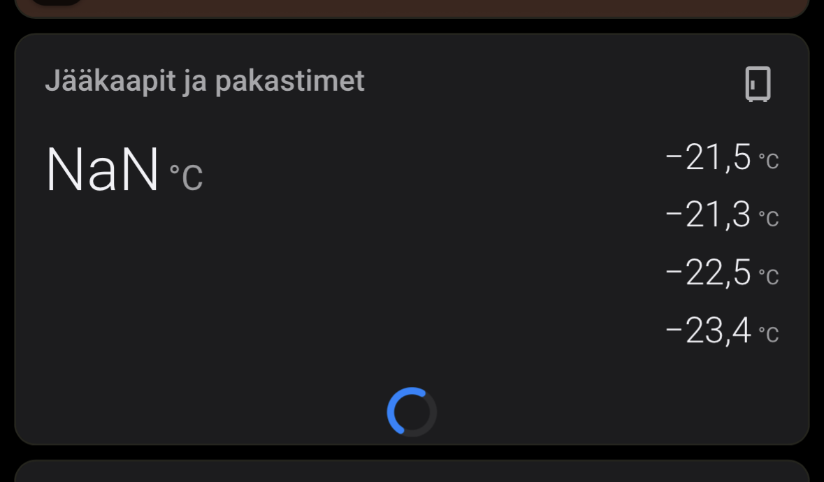

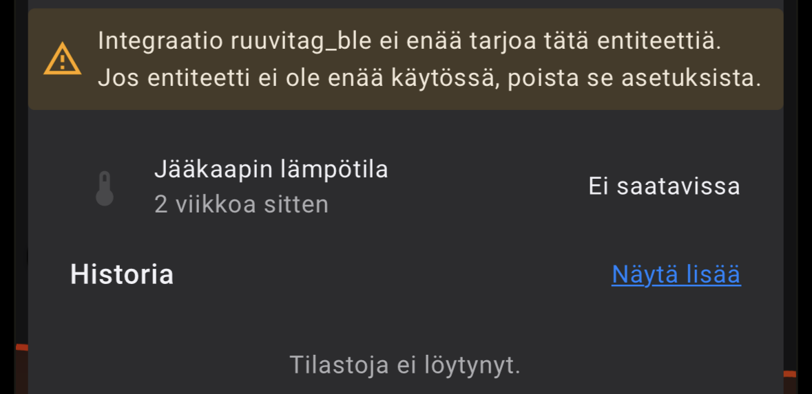

Any idea how to solve situation where the graph does not load when the main entity is temporarily not available? This happens periodically when some of my BLE RuuviTags drop outside receiver range or battery runs empty (like in this example).
The other entities in this graph could, and should, still be shown but instead it just has the loading indicator:
Are you sure the entity becomes “unavailable”? Seems that it becomes “not existing” which I consider as an emergency case. Anyway, browse for last 5-10 recently closed issues in m-g-c repo, they are about the same; if you do not want to be alerted by m-g-c about this emergency case, disable the “loading_indicator” (check Docs).

Some of your entities do not exist, not unavailable.
If you do not care about missing entities - use “loading_indicator: false”. Care to read at least a post before yours.

Spinner is shown if some entity does not exist. Also, purge your browser cache just in case.
