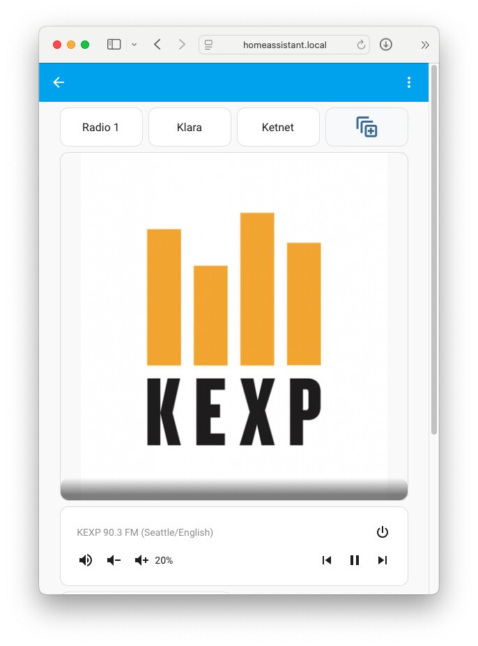

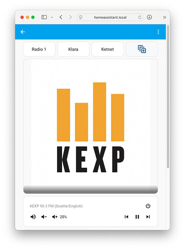

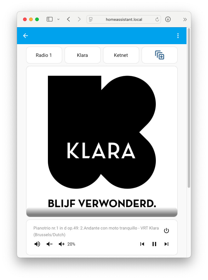

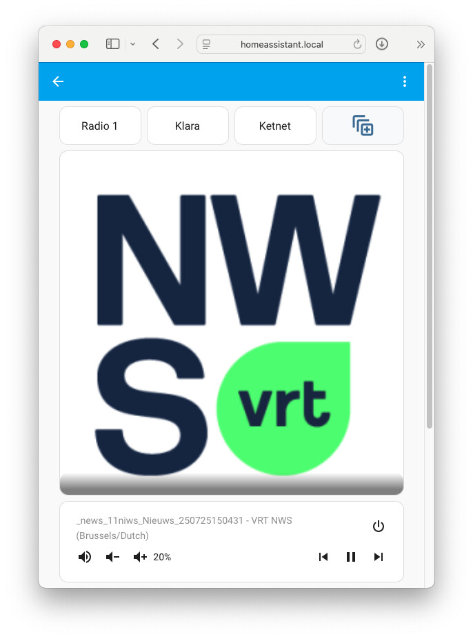

I’ve separated the “cover” (which I want to see in full) from the controls, so I have two separate Mini Media Player cards:
  • one for (only) the cover, and
  • one for the controls.
But on the cards with only the cover, I’m getting a grey strip/shadow I cannot get rid off. Can someone help me here?

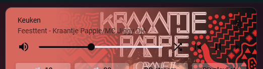

Is there anyone that can help making the control’s more contrasting when using artwork: material? I was thinking of a 50% opacity rounded background, but no idea how to achieve this.
Post your current card code to start…
Sure, here it is.

That helps a bit, but there are still situations that it is hard to see. Also, the state of the shuffle button is always invisible because it seems to be overruled by some other color.

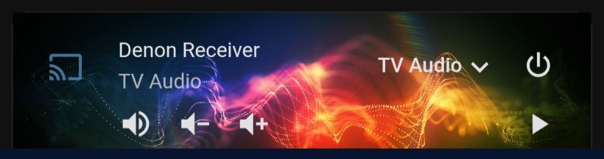

I love this cards and use it a lot, but today when I was creating a new card with this for my Denon receiver I was having some troubles.
First of all, the volume slider shows as 0 while the volume is higher, which could be because the actual reported volume of denon is 0.28 instead of 28 in the integration. When you use the slider it correctly sets the volume though (slider set to 28 sets the volume to 28 on the receiver and 0.28 in the integration).
And using the slider for control of the volume in the HA app is really enjoying so I wanted to go with the stateless controls and that worked great but the problem with that is that I would like to have the actual volume being shown in the player. Because that is not shown as it is with using the slider (even though you barely see it at that point due to your finger being in the slider).
Is there a way to display the volume_level attribute in the player or as a shortcut button?
Also the documentation says you can hide volume_level, but actually displaying it does nothing?
