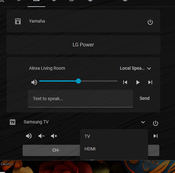

when the card is at the bottom of the screen it shows the source list at the bottom and not at the top of the card.
I’m up-to-date with the fix releases in 2026.3.x but still encounter this drop-down list issue. Do I have to something extra?
I have what I think is a similar problem with the shortcuts’ list. It is displayed at the very bottom of the card and since the card is at the bottom of the screen, the pop-up list disappears out of sight.
Although the screen can be scrolled to bring the list menu back into view, it would be better if the UI took notice of where it was and ensured the pop-up is displayed on the screen, so if at the bottom, make it a pop-up rather than a drop-down menu.
Is there anyway to make the list actually pop up?
Or if the list was placed above the buttons so more room for it to drop down. I tried but it always places the buttons above the list which is then at the very bottom, with the aforementioned problem.
Anyone found a way to avoid this issue?

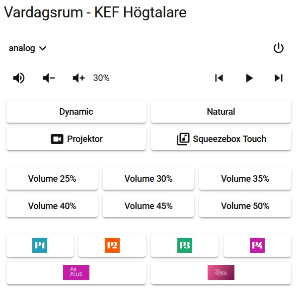

Is there anyway to control the "status of color of a button"?
Example:
Here is my mini media player setup, and well it would be nice if one could for example highligt the selected source (Projector or Squeezebox Touch), or selected lamp mode of the projector (Dynamic or Natural). Also would be nice to do the same for the fixed volume buttons (as in, show which level it is currently at, so if it is between say 25 and 30 - no button is "marked", only when at matching levels, although I guess that might be harder). And just as the last two rows, which is radio stations (which are played over Squeezebox Touch).
Is there any way to control for example the background color of each button - and if so, is there anyway to have code that handles the logic behind (for example volume in this case)?

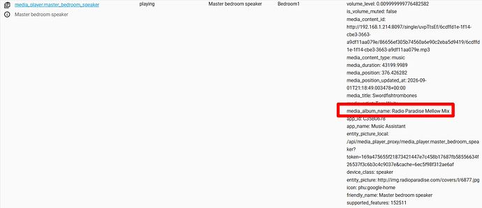

Is there a way to display the “media_album_name:” attribute from the media_player ?
My radio station of choice is Radio Paradise but I switch between the various options e.g. Radio Paradise Main Mix, Radio Paradise Mellow Mix etc. This is held in the “media album name” attribute but I can’t see a way to display it in the MMP.
