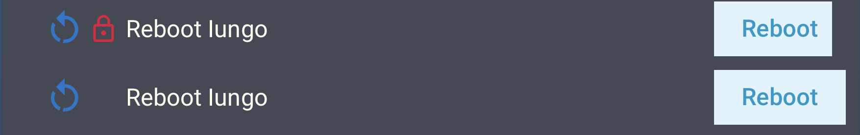

with 2025.8 we get new Button elements styling in the cards. It reveals something I never noticed before:
      - type: custom:restriction-card
        row: true
        card_mod: !include /config/dashboard/card_mods/restriction_lock.yaml
        card:
          entity: script.reboot_iungo
          action_name: Reboot
        restrictions:
#           block: true
          confirm:
            text: Bevestig Iungo herstart?
      - entity: script.reboot_iungo
        action_name: Reboot
Somehow it takes away from the button elements available space on the right side. Because of that, the text is no longer centered.
Maybe some padding on the row, or another property, I didnt yet inspect too thoroughly.
can set a margin-right on the overlay in Inspector, but that just moves the shorter button, it doesnt make it as wide as the core button
Might be worth a look as it really makes the Buttons look bad

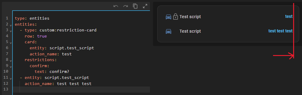

Will take a look when be near a pc.
Both labels are right-aligned, see no issue here:
type: entities
entities:
    row: true
    card:
      entity: script.test_script
      action_name: test
    restrictions:
      confirm:
        text: confirm?
  - entity: script.test_script
    action_name: test test test

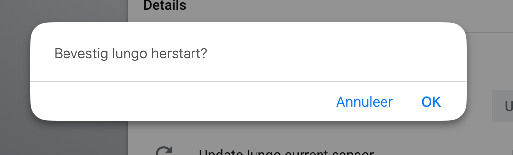

all of a sudden I see this in console
[RC] render() → bailing early (missing required state)
Scherm­afbeelding 2026-03-31 om 13.46.16
dont think I touched those configs in ages, so could it be an update took place
unless
 I moved back to release, and stopped using a manual edited card
 It now dawns on me . I think
 nope that was another. now where to start looking for an answer to this.
filed it, and downgrading to 1.2.19 fixes
only downside I see is the ancient confirmation dialog
