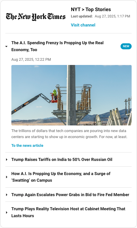

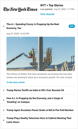

I’d like to share a custom Lovelace card I built: RSS Accordion Card.
It displays RSS feed items from a sensor (feedparser) or an event entity (feedreader) in a clean accordion style directly in your Home Assistant dashboard.
Screenshot
Features
  • Display feed items in collapsible accordion sections.
  • Support for both sensor (Feed Parser) and event (Feedreader) entities.
  • Option to only allow one accordion item open at a time.
  • β€œNEW” pill for recent articles (configurable, 1 hour by default).
  • Visited items are greyed out for easier distinction.
  • Show a hero image if provided by the feed (hides duplicates in summary).
  • Channel information support (title, description, image).
  • Optionally crop the channel image to a neat 60x60 circle.
  • Show last channel update time (channel.published) if available.
  • Auto-open the newest item on card load.
  • Configurable number of feed items.

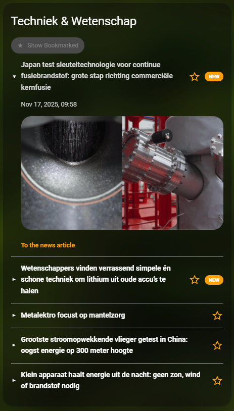

Great card, love how you can collapse the feed item and the other options like new, i use it with feedparser but its shows an error displaying the date but the feed shows and but it shows just one feed item and no images. Same with feedreader but no date error but only one feed item no images. Can you share the config what you use with the New York Times ?
Solved, i ask grok to change the sensor.py file for me because i am a noob in code. Works perfect.
Could you please share how you fixed the date and image issue? Perhaps that needs to be raised on the GItHub repo as an issue and fix?
i ask grok to change the sensor.py file for me and he did a good job :wink:
grok has changed the code for me, i don’t have any code knowledge.
The code works on some feeds not all, there is no general fix, i had to copy the code from the sensor.py and the rss feed data to grok because not every rss feed uses the same format what can be read by RSS Accordion. So if people like to use it and like to change it with grok, make a copy of your sensor.py from here /homeassistant/custom_components/feedparser and the feed data from developers β€”> states β€”> sensor.yourfeed entity (just from one feed entry).
Its the same as the media player from the card, on some podcast RSS feeds it shows but not all just because the formats used in the feed is different and the player is not shown. So there is no need to to add the code to github repo.
Below is the config for the card feed i use for feedparser
- platform: feedparser
  name: Techniek en Wetenschap
  feed_url: 'https://tw.nl/feed'
  date_format: "%a %d %b %Y %H:%M"
  scan_interval:
    hours: 2
  show_topn: 5
  inclusions:
      - title
      - summary
      - link
      - published
      - description
      - id
      - duration
      - image
      - media
## Techniek en Wetenschap
- platform: template
  sensors:
    techniek_en_wetenschap_attributes_0:
      friendly_name: "Techniek en Wetenschap Content 0"
      value_template: >
        {{ states.sensor.techniek_en_wetenschap.attributes.entries[0].title }}
