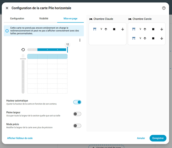

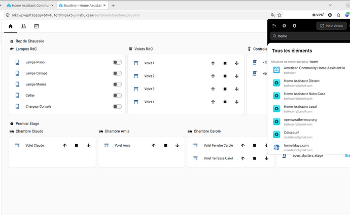

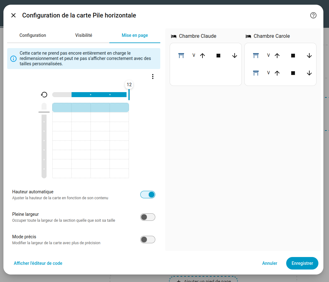

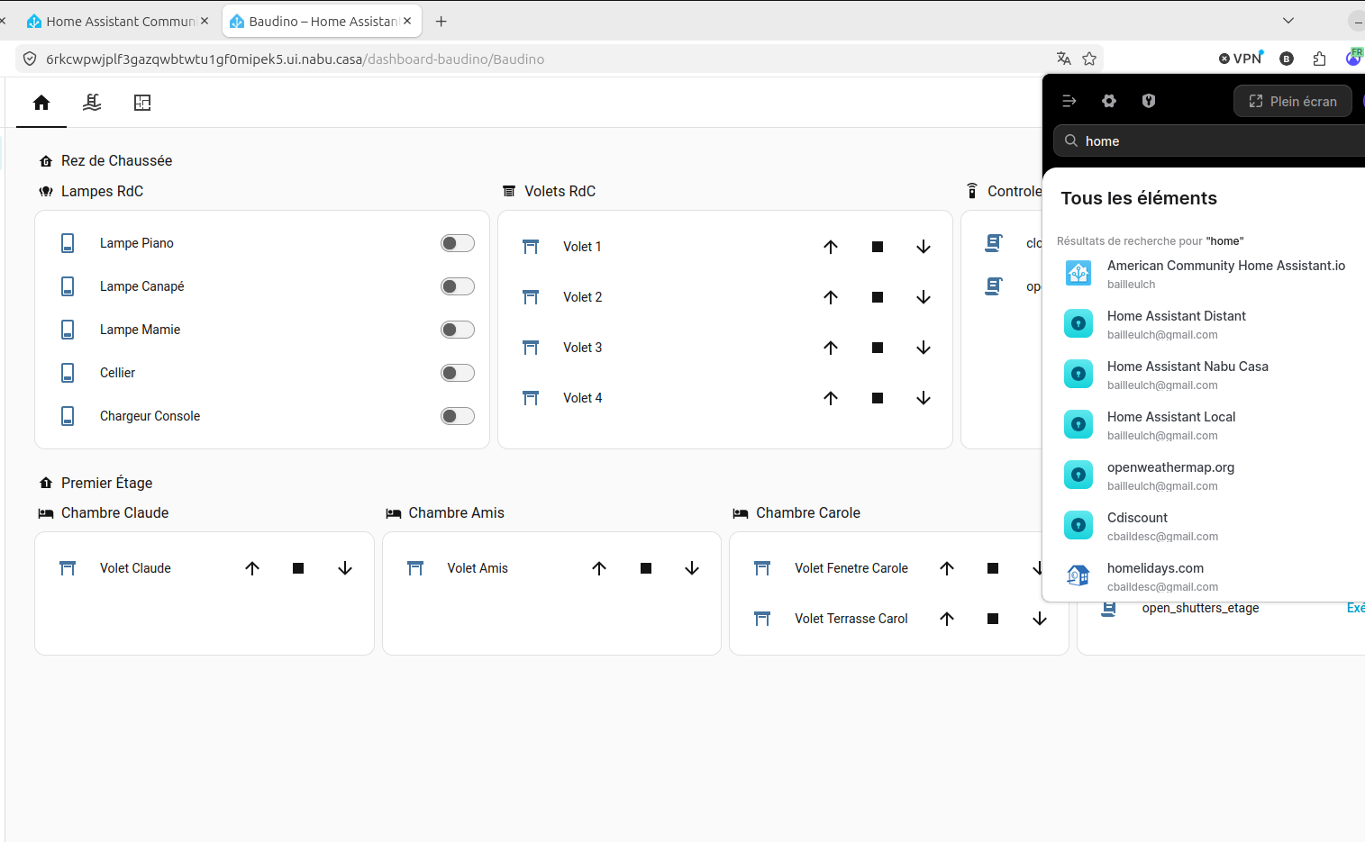

To show how I mismanage my dashboard : I Want to have a version of this dashboard for my Samsiung Tablet.

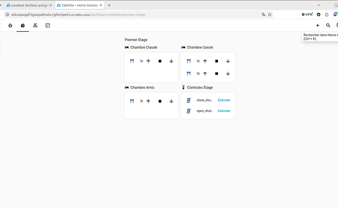

It cannot handle the width of 3 columns, si I tried to adapt the duplicate For 2 columns
First Floor has 4 entities, so I Tried two horzontal stacks

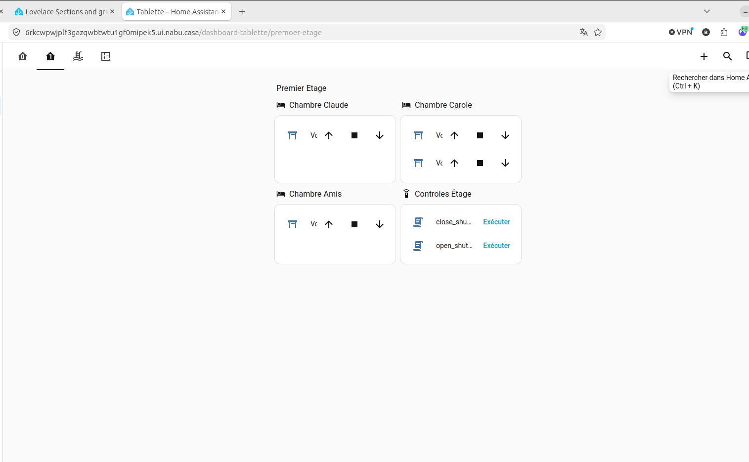

On the original First Floor is 1*4 => so i tried to turn to 2 * 2 and here comes the worst :slight_smile:

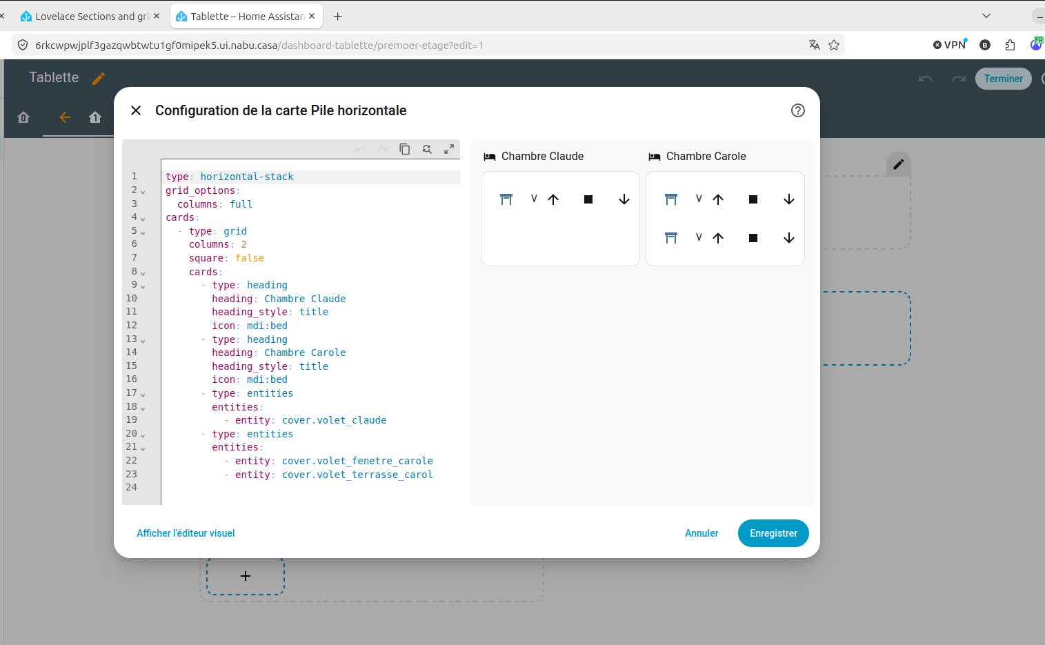

It takes a part only of the screen width and I absolutely can't Order it to be wider
Neither via UI nor via Yaml I master the subject enough to be obeyed
I am not a know nothing, but a far from knowing enough to be at ease with Sections Dashboards
Thanks in advance
In 'Mise en page', the toggle Full width should be On, but it does not correct the problem.
Horizontal Stack still complains : I wish I could but I can't

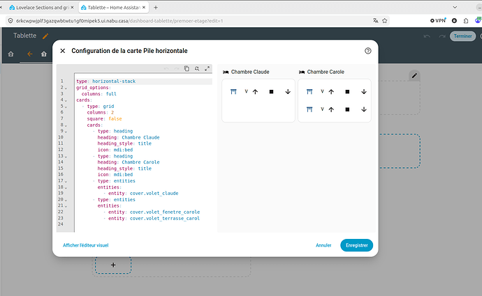

So, we went down to Lovelace Tablette, in Json (not a place for honest user to go)
And aroundi Sections definitions we found a few strange things about forgotten columns : 4
So, perhaps my problem was out of my reach, (which stays : The integration of Dashboard Sections in my mind is not correct. How to climb the steps is still the question)
The Json game :
