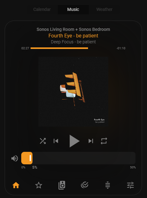

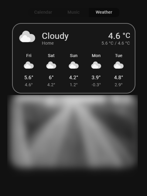

I’ve been working on a swiper card for some time now and it displays my calendar, a sonos card , and a weather card.
Now I want to try to make it conditional to show a specific slide if a condition is filled.
For example if music is playing then display the sonos card.
If the time is inbetween 06:00-10:00, display the calendar card.
Right now I have the Sonos card as “start_card:” and thinking if that can be modified or maybe using the "swiper.slideTo(index, speed, runCallbacks)?

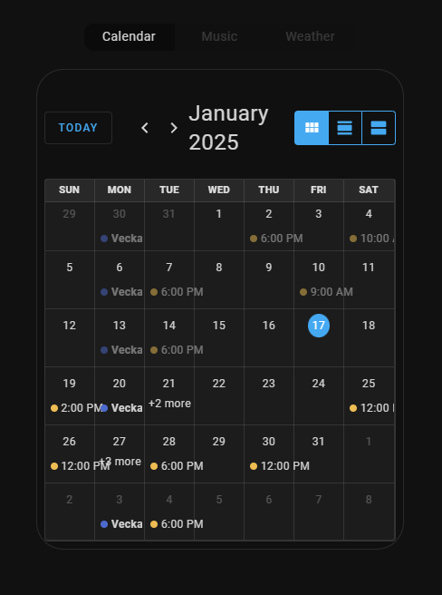

Here’s the code for my current card without any conditions to display a certain slide(added title cards as placeholders):
Also attached a screenshot of what the card looks like:

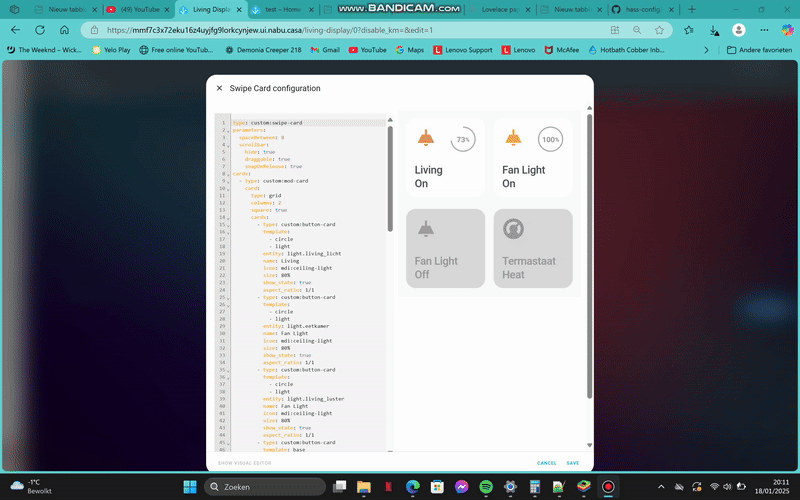

I have a problem it won’t load on my Dashboards but it will on edit.
can someone help me
bandicam2025-01-1820-11-25-261-ezgif.com-video-to-gif-converter
code:
type: custom:swipe-card
parameters:
  spaceBetween: 8
  scrollbar:
    hide: true
    draggable: true
    snapOnRelease: true
cards:
  - type: custom:mod-card
    card:
      type: grid
      columns: 2
      square: true
      cards:
        - type: custom:button-card
          template:
            - circle
            - light
          entity: light.living_licht
          icon: mdi:ceiling-light
          show_state: true
          aspect_ratio: 1/1
          template:
            - circle
            - light
          entity: light.eetkamer
          show_state: true
          aspect_ratio: 1/1
          template:
            - circle
            - light
          entity: light.living_luster
          show_state: true
          aspect_ratio: 1/1
          template: base
          entity: climate.livingroom
          icon: mdi:thermostat
          show_state: true
          aspect_ratio: 1/1
          tap_action:
            action: call-service
            service: browser_mod.popup
              dismissable: true
              autoclose: false
              content:
                type: custom:mushroom-number-card
                display_mode: buttons
                icon_color: primary
              title: Edit Temperature
              entity_id: sensor.living_temperature
        - type: custom:gap-card
          height: 8px
    style: |
      ha-card {
        max-width: 480px;
        max-height: 480px;
        margin: 0 auto;
        padding: 8px;
    card:
      type: grid
      columns: 2
      square: true
      cards:
          template:
            - circle
            - light
          show_state: true
          aspect_ratio: 1/1
          template:
            - circle
            - light
          show_state: true
          aspect_ratio: 1/1
          template:
            - circle
            - light
          show_state: true
          aspect_ratio: 1/1
          template: base
          show_state: true
          aspect_ratio: 1/1
          tap_action:
              dismissable: true
              autoclose: false
              content:
                icon_color: primary
          height: 8px
    style: |
      ha-card {
        max-width: 480px;
        max-height: 480px;
        margin: 0 auto;
        padding: 8px;
is it possible with card-mod ?
