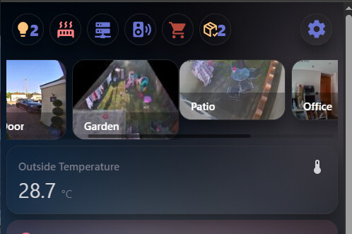

Can someone tell me why my last 3 camera entities are smaller than the first 3?
This is my code:
type: custom:swipe-card
parameters:
  scrollbar:
    hide: true
  grabCursor: true
cards:
  - type: grid
    columns: 3
    square: false
    cards:
      - type: picture-glance
        title: Driveway
        show_name: false
        camera_image: camera.driveway_high_resolution_channel
        camera_view: auto
        fit_mode: cover
        entities: []
        title: Front Door
        show_name: false
        camera_image: camera.front_door_high_resolution_channel
        camera_view: auto
        fit_mode: cover
        entities: []
        title: Garden
        show_name: false
        camera_image: camera.back_garden_high_resolution_channel
        camera_view: auto
        fit_mode: cover
        entities: []
  - type: grid
    columns: 3
    square: false
    cards:
        title: Patio
        show_name: false
        camera_image: camera.patio_high_resolution_channel
        camera_view: auto
        fit_mode: cover
        entities: []
        title: Office
        show_name: false
        camera_image: camera.office_high_resolution_channel
        camera_view: auto
        fit_mode: cover
        entities: []
        title: Office Rear
        show_name: false
        camera_image: camera.office_rear_high_resolution_channel
        camera_view: auto
        fit_mode: cover
        entities: []
