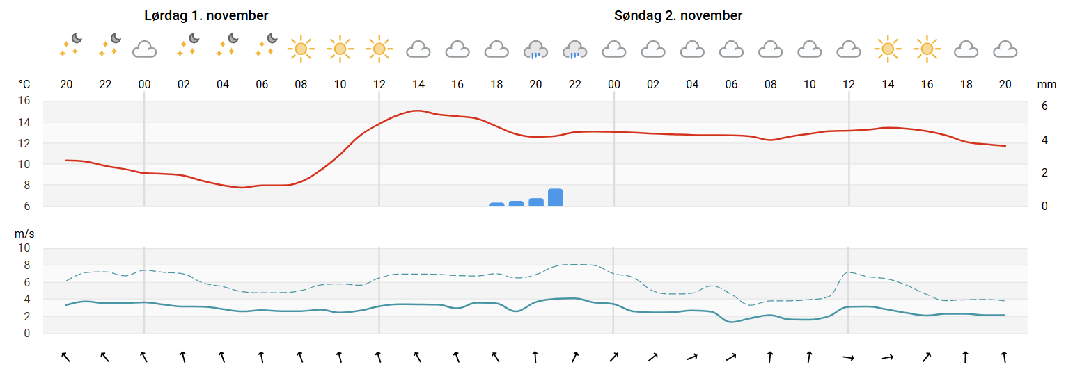

  1. having a horisontal grid with banding, see example from dmi.dk below, could provide a more instant overview without having to read digits
  2. then showing the digits could be made optional
  3. showing the date or time header could be made optional, or at least to omit “:00” in each hour
  4. there could then be an alternative to have the weather icon there instead

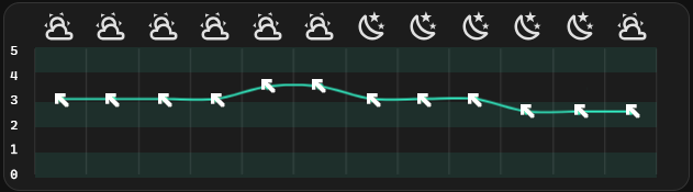

  5. an alternative configuration to show a wind speed diagram having the direction icon where the temperature number is now
  6. the windspeed data is ovewflowing when type: hourly is used and number_of_forecasts is >10
A wind speed mock up for the next 12 hours.
The current way I set it up showing how the wind speed overflow to the right when having more than 10 hours selected.

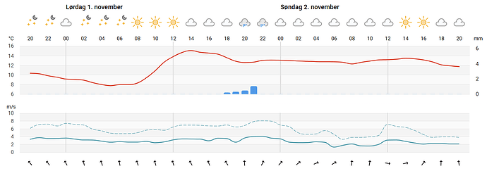

How dmi.dk utilise banding to and a vertical axis to avoid having to show digits.
… and their wind speed chart.
