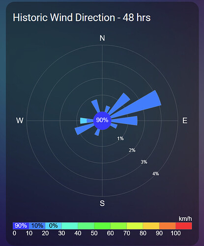

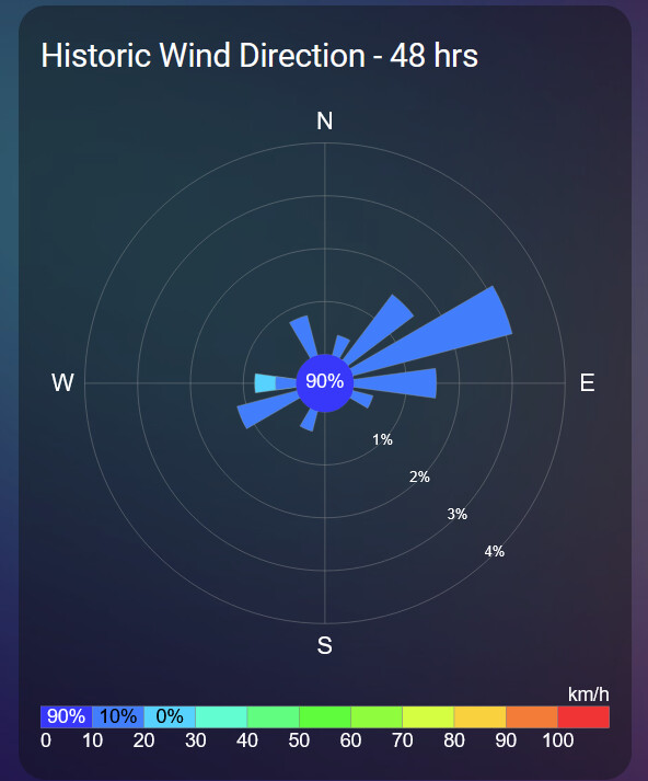

idk if it is special enough, but i wonder if even not so special configs would help you to see how the card is really used out in the wild…
type: custom:windrose-card
title: Historic Wind Direction - 24 hrs
center_calm_percentage: true
current_direction:
  hide_direction_below_speed: 10
  show_arrow: true
data_period:
  hours_to_show: 24
direction_labels:
  cardinal_direction_letters: NOSW
  cardinal_directions_text_size: 60
  custom_labels:
    ene: ONO
    ese: OSO
    ne: "NO"
    nne: NNO
    se: SO
    sse: SSO
  intercardinal_directions_text_size: 45
  secondary_intercardinal_directions_text_size: 30
  show_cardinal_directions: true
  show_intercardinal_directions: true
  show_secondary_intercardinal_directions: true
matching_strategy: direction-first
max_width: 400
output_speed_unit: kph
refresh_interval: 60
speed_range_beaufort: false
wind_direction_entity:
  direction_compensation: 0
  direction_unit: degrees
  entity: sensor.gw1100a_wind_direction
  use_statistics: false
windrose_draw_north_offset: 0
windspeed_bar_full: true
windspeed_bar_location: bottom
windspeed_entities:
  - entity: sensor.gw1100a_wind_speed
    speed_unit: kph

Mine is a configuration that I got from an example weather dashboard on Reddit:
title: Historic Wind Direction - 48 hrs
data_period:
  hours_to_show: 48
max_width: 400
  entity: sensor.ws2900_v2_02_04_wind_direction
windspeed_entities:
  - entity: sensor.ws2900_v2_02_04_wind_speed
    speed_unit: kph
cardinal_direction_letters: NESW

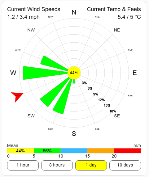

Pretty basic, but with a bit more weather related data added
data_period:
period_selector:
location: bottom
active_color: black
active_bg_color: yellow
buttons:
- hours: 1
title: 1 hour
- hours: 8
title: 8 hours
- hours: 24
title: 1 day
active: true
- hours: 240
title: 10 days
refresh_interval: 300
entity: sensor.wind_direction
windspeed_entities:
  • entity: sensor.wind_speed
    speed_unit: mph
    output_speed_unit: mph
    speed_ranges:
    • from_value: 0
      color: yellow
    • from_value: 5
      color: rgb(0,255,0)
    • from_value: 10
      color: hsl(200, 100%, 60%)
    • from_value: 15
      color: orange
    • from_value: 20
      color: red
      current_direction:
      show_arrow: true
      arrow_size: 100
      hide_direction_below_speed: null
      direction_labels:
      intercardinal_directions_text_size: 40
      secondary_intercardinal_directions_text_size: 20
      corner_info:
      top_left:
      label: Current Wind Speeds
      unit: " mph"
      entity: sensor.wind_speeds
      label_text_size: 50
      value_text_size: 50
      input_unit: null
      output_unit: null
      precision: null
      top_right:
      label: Current Temp & Feels
      entity: sensor.temperature_chill
      unit: " °C"
      label_text_size: 50
      value_text_size: 50
      input_unit: null
      output_unit: null
      precision: 1
      actions:
      top_left:
      tap_action:
      action: more-info
      top_right:
      tap_action:
      action: more-info

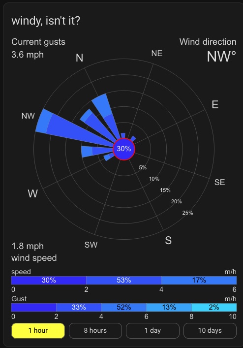

I have never managed to get the red triangle for wind direction working (I really need to read the docs again) but here is mine:
title: windy, isn't it?
data_period:
  period_selector:
    location: bottom
    active_color: black
    buttons:
      - hours: 1
        title: 1 hour
      - hours: 8
        title: 8 hours
      - hours: 24
        title: 1 day
        active: true
      - hours: 240
        title: 10 days
max_width: 400
windspeed_bar_full: false
  entity: sensor.gw2000b_wind_direction
windspeed_entities:
  - entity: sensor.gw2000b_wind_speed
    speed_unit: auto
  - entity: sensor.gw2000b_wind_gust
    speed_unit: auto
speed_range_max: 40
speed_range_step: 2
windrose_draw_north_offset: -26
current_direction:
  show_arrow: true
  arrow_size: 50
  center_circle_size: 30
corner_info:
  top_left:
    label: Current gusts
    unit: " mph"
    label_text_size: 50
    value_text_size: 50
    precision: 1
  top_right:
    label: Wind direction
    unit: °
    input_unit: degrees
    output_unit: letters
  bottom_left:
    label: wind speed
    unit: " mph"
    label_text_size: 50
    value_text_size: 50
    precision: 1
direction_labels:
  show_secondary_intercardinal_directions: false
