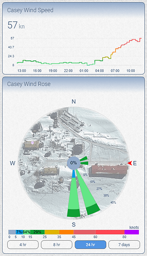

Is there something wrong here or am I not understanding something?
If I show the last 4 hours I see the strong wind speeds, though they are not all in the correct bin of speeds:
However if I show the last 8 hours the strong winds disappear:
They should be still there for at least 50% of the time.
Likewise for 24 hours (the span of the chart above):
type: custom:windrose-card

Hi Tom,
That looks strange.
Your input speed unit is ‘auto’. What unit is your entity using? Also knots?
Your configuration uses some deprecated properties. I think it’s good to fix this first.
The properties output_speed_unit, speed_range_beaufort en speed_ranges can be moved to the windspeed_entities level. Please check the readme for the deprecated ones, there are more.
Have you tried other matching strategies? See the readme for the differences between the strategies.
An option that could help explain this, set log_measurement_counts to true and have a look add the numbers logged in the browsers console (F12)
If we still cannot explain this, please submit an issue in GitHub.
https://github.com/aukedejong/lovelace-windrose-card/issues/new
Maybe a bug. :cold_sweat:
