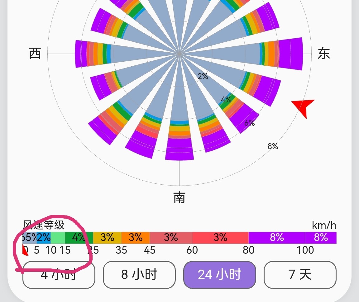

text spacing bug…
Not using a relative scale could fix this.
windspeed_entities:
  - entity: sensor.wind_speed
    render_relative_scale: false
Or using vertical bars:
windspeed_bar_location: right
Make the percentage texts smaller, will make them unreadable.
Do you know an other solution?
