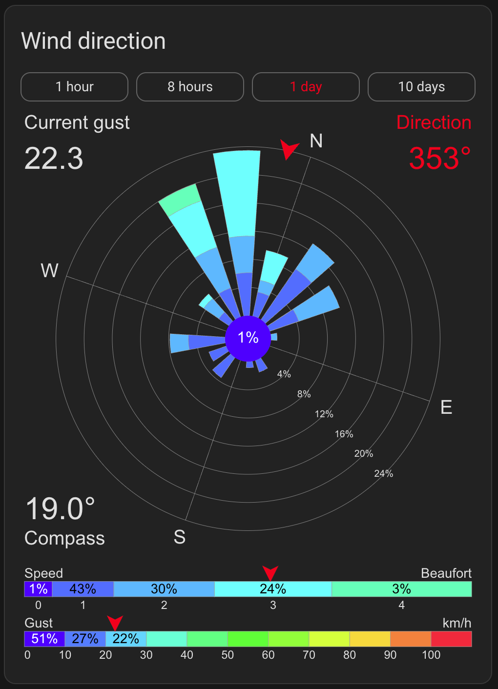

Hi! I am using your Windrose Card since about two years and love it very much! Thank you so much for your work. :heart_eyes:
I am wondering if you could create a similar card for lightnings. There are sources like https://blitzortung.org which already can be used within Home Assistant.
There is some information like
  • what was the distance to a lightning
  • when did it happen
  • what was the direction
I think about a configurable card showing all lightnings within maybe the last hour and within a distance of maybe 100km. It would be interesting then to see how often there are lightnings from any direction and how far they are.
What do you think? Isn’t this similar to the Windrose card?
Thank you in advance
Ruediger
Hi Ruediger,
Other people used this card to display lightning data.
See these GitHub issues:
An other sort of circular graph with distance from centre and color intensity indicating how long ago the lighting happened, would be better for lightning data.
I don’t have the time the make something like that, maybe in the future. You can add an issue in GitHub, I’ll give it the ‘new card request’ label.
Someone else requested a compass card, maybe this could be a feature of a more advanced compass card.
Thanks for using windrose-card.
Auke

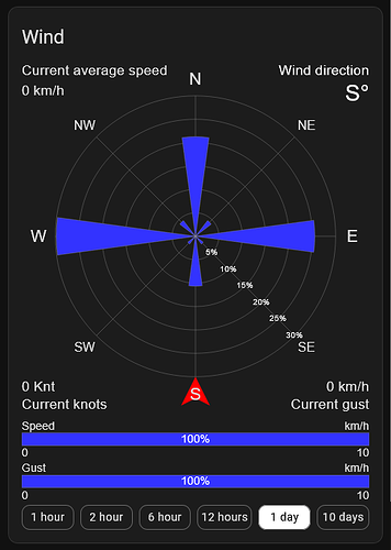

I would like to have this as a sample configuration. Thx!
Here’s a starting block with mine:
You will need to modify the sensor entities, and change other styling variables.
You can remove the corner entity values (e.g. Current knots in bottom left) without messing up the code else-where.
Changing the wind direction from NOZWX may be required if your weather station has a precise bearing direction in degrees (rather than mine for only 8 segments).
Do check with the GitHub table of variables. It is very helpful.
type: custom:windrose-card
title: Wind
data_period:
  period_selector:
    location: bottom
    active_color: black
    active_bg_color: white
    log_measurement_counts: true
    buttons:
      - hours: 1
        title: 1 hour
      - hours: 2
        title: 2 hour
      - hours: 6
        title: 6 hour
      - hours: 12
        title: 12 hours
      - hours: 24
        title: 1 day
        active: true
      - hours: 240
        title: 10 days
refresh_interval: 30
windspeed_bar_location: bottom
wind_direction_entity:
  entity: sensor.weather_station_esp32_station_wind_direction_bearing
  use_statistics: false
  direction_compensation: 0
  direction_letters: NOZWX
windspeed_entities:
  - entity: sensor.weather_station_esp32_station_wind_speed
    speed_unit: false
    use_statistics: true
    windspeed_bar_full: false
    output_speed_unit: kph
    speed_range_beaufort: false
  - entity: sensor.weather_station_esp32_station_wind_gust
    speed_unit: false
windrose_draw_north_offset: 0
current_direction:
  show_arrow: true
  arrow_size: 100
  center_circle_size: 30
corner_info:
  top_left:
    label: Current average speed
    unit: " km/h"
    label_text_size: 50
    value_text_size: 50
    input_unit: kph
    output_unit: kph
    precision: 1
  top_right:
    label: Wind direction
    unit: °
    color: white
    input_unit: degrees
    output_unit: letters
  bottom_left:

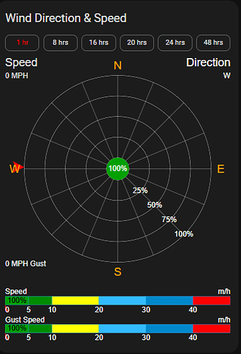

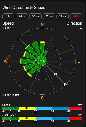

Here’s another example with the code for mine (not very windy so I have two screen snapshots):
title: Wind Direction & Speed
circle_legend_text_size: 40
data_period:
  period_selector:
    buttons:
      - hours: 1
        title: 1 hr
      - hours: 8
        title: 8 hrs
      - hours: 16
        title: 16 hrs
      - hours: 20
        title: 20 hrs
      - hours: 24
        title: 24 hrs
      - hours: 48
        title: 48 hrs
refresh_interval: 300
windspeed_bar_full: true
  entity: sensor.ridgewood_estate_personal_weather_station_wind_dir
  direction_letters: NESWX
windspeed_entities:
  - entity: sensor.ridgewood_estate_personal_weather_station_wind_speed
    current_speed_arrow_location: below
    speed_unit: mph
    output_speed_unit: mph
    current_speed_arrow: true
    speed_ranges:
      - from_value: 0
        color: rgb(0,160,0)
      - from_value: 5
        color: rgb(0,140,0)
      - from_value: 10
        color: yellow
      - from_value: 20
        color: hsl(200, 100%, 60%)
      - from_value: 30
        color: hsl(200, 100%, 40%)
      - from_value: 40
        color: red
  - entity: sensor.ridgewood_estate_personal_weather_station_wind_gust
    speed_unit: mph
    speed_ranges:
      - from_value: 0
        color: rgb(0,160,0)
      - from_value: 5
        color: rgb(0,140,0)
      - from_value: 10
        color: yellow
      - from_value: 20
      - from_value: 30
      - from_value: 40
        color: red
current_direction:
  show_arrow: true
  arrow_size: 60
compass_direction:
  auto_rotate: false
  entity: input_number.compass
corner_info:
  top_left:
    label: Speed
    unit: " MPH"
    label_text_size: 60
    value_text_size: 40
    input_unit: mph
    output_unit: mph
    precision: 2
  top_right:
    label: Direction
    color: white
    label_text_size: 60
    value_text_size: 40
    input_unit: degrees
  bottom_left:
    label: null
    unit: " MPH Gust"
    color: white
    label_text_size: 60
    value_text_size: 40
    input_unit: mph
    output_unit: mph
direction_labels:
  cardinal_direction_letters: NESW
  show_cardinal_directions: true
  show_intercardinal_directions: true
  show_secondary_intercardinal_directions: true
  cardinal_directions_text_size: 60
  intercardinal_directions_text_size: 0
  secondary_intercardinal_directions_text_size: 0
  center_calm_percentage: true
colors:
  rose_lines: rgb(255,255,255)
  rose_cardinal_direction_labels: orange
  rose_intercardinal_direction_labels: purple
  rose_secondary_intercardinal_direction_labels: yellow
  rose_center_percentage: white
  rose_percentages: white
  rose_current_direction_arrow: red
  bar_border: hsl(200, 100%, 60%)
  bar_unit_name: white
  bar_name: white
  bar_unit_values: white
  bar_percentages: auto
