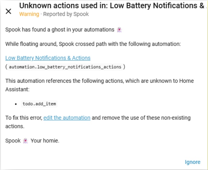

In this blueprint, you have the option to add your low-battery report to a To-Do list using the Easy Notify – Device Action Buttons.
The To-Do integration is provided and maintained by Home Assistant, but it is not installed by default. If you want to use it, you’ll need to add it manually.
You can find the integration here: Home Assistant – To-Do Integration
If you haven’t installed the integration yet, Spook may detect that this blueprint references the todo integration but can’t find it, and will show a warning.
You have two options:
  1. Click Ignore on the warning if you don’t plan to use the To-Do integration.
  2. Install the To-Do integration in your Home Assistant instance.
This is completely safe, the integration is official and maintained by Home Assistant.
