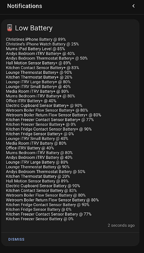

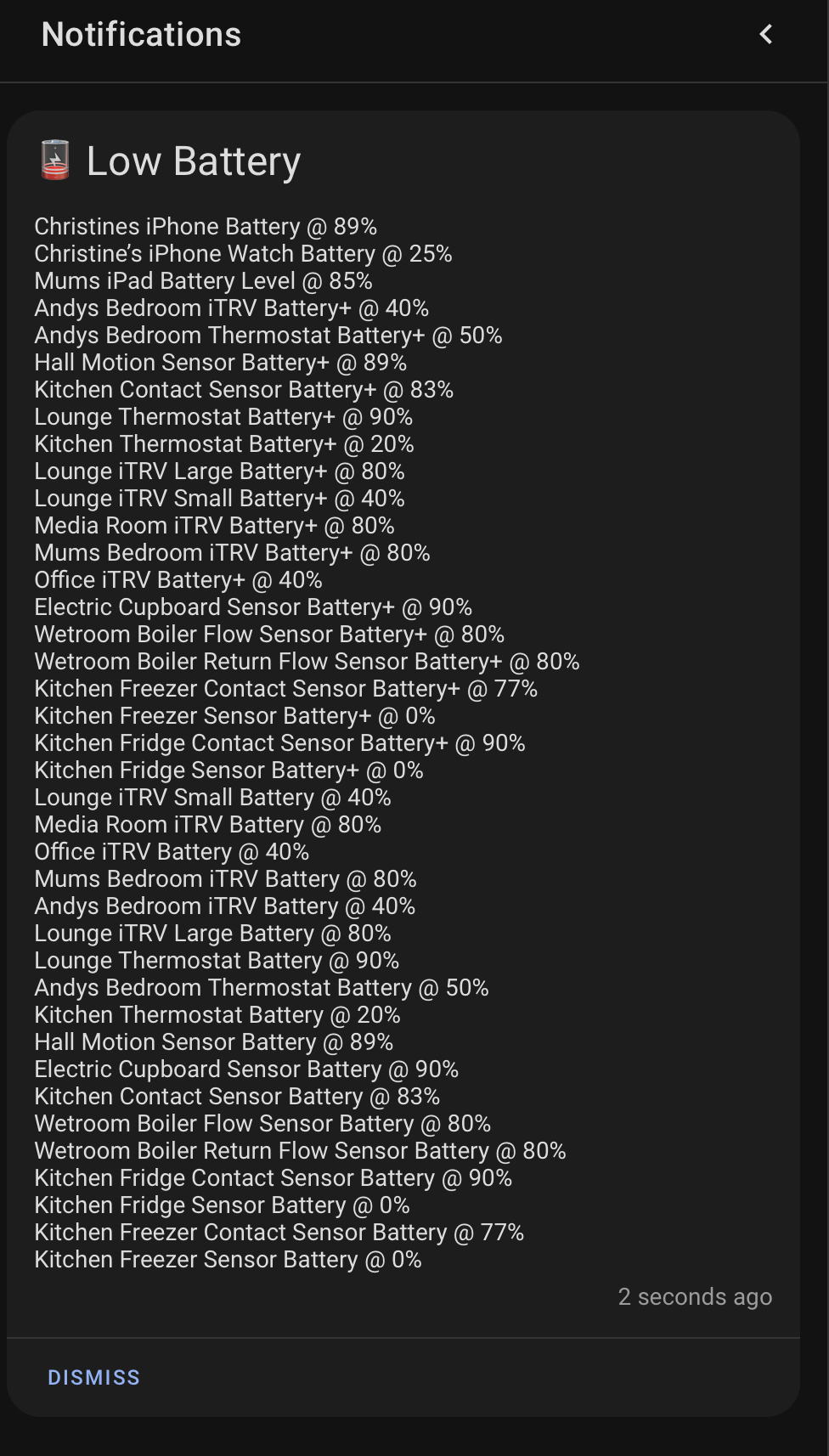

HI, thanks for your great blue print.
I have two questions.
Is there a way to add Messages to telegram addional to HA notifications?
and is there a way to exluce a whole integration? I’m using battery+ and all devices get double notifications

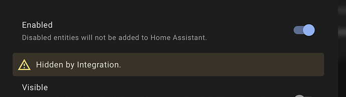

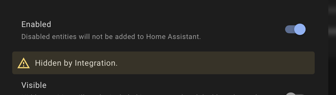

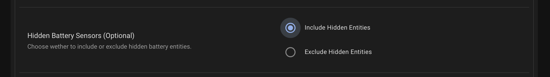

@Blacky I have added the ability to exclude Hidden entities, this is useful when using the integration Battery Notes which has the option to hide the default battery entities and only show Battery+ one. See below
Hidden Entities Included
Hidden Entities Excluded
you can find my forked gitst here: low-battery-notifications-and-actions.yaml · GitHub
If you could add this support to your version it would be really appreciated.
Andy
@andyblac
Thanks Andy, I will think about it. I have recently added the ability to exclude entities using labels. You can apply a label to all you hidden batteries and then exclude them all. This was done for Battery+ as it duplicates the entities.
Blacky :grinning:
@Blacky Thanks, yeah, I Know, but it requires you to remember to add the label each time you add a new device :), Using the builtin Hide option works automatically, plus when you have loads of batteries to deal with it becomes an annoyance.
