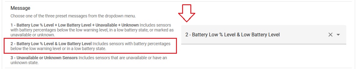

How do i filter out all unknown and unavailable devices from showing in the notification automatically not one by one?
@archmisha
If your using easy notify just select option 2. See below.
Blacky :grinning:
