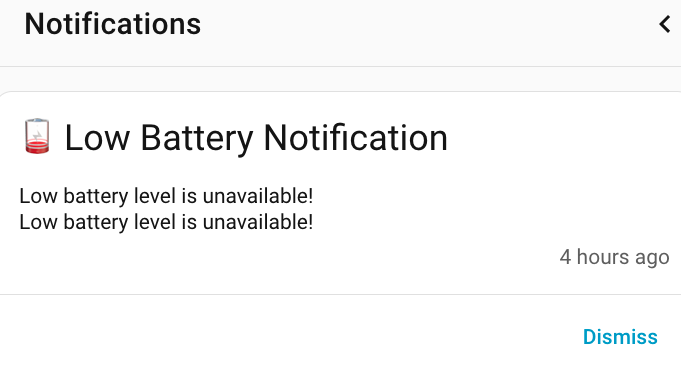

For the past few days, I have been getting this warning at the same time each day. All of my battery devices look fine. I am running Version 2.6 and never had this issue. Help, please :slight_smile:
@HA11
You have 2 batteries entities that are unavailable. Both have the same name of Low battery level and the is unavailable comes from the blueprint.
Go into Device & services > entities tab at the top and search for Low battery level. You can also use the filter status of unavailable and you will see them both.
Blacky :grinning:
Much appreciated. So originally what I did is check every battery device and all were/are ok. I just did what you suggested and I have 2 entries for the same device. Why would this be? The device works perfectly and the battery is at 95%.
Here’s what HA says:
This entity is no longer being provided by the zwave_js integration. If the entity is no longer in use, delete it in settings.
@HA11
I’m not completely sure, but I believe this entity originally reported Low battery (as a binary state) rather than a percentage. The zwave_js integration later removed it in an update to better align with the Z-Wave specification, which defines battery status through percentage reporting and notifications instead of a fixed ā€œLowā€ entity.
Your device reports battery as a percentage, which is much better than a simple Low indicator. For the blueprint, this works perfectly since you can decide the exact threshold at which it should be reported, rather than relying on a fixed ā€œlowā€ state.
As HA mentioned, you can delete the entity. In some cases it can be removed directly, but if not, you can simply disable it. For those who want it gone completely, removing and re-adding the device will prevent the entity from being created again. Keep in mind that doing this will reset history and may create new entity IDs, which could affect existing automations.
Now it’s up to you how you want to handle it. If you ask me, I’d try deleting the entity first. If that doesn’t work, I’d remove and re-add one device to see how it goes. If everything works well and I’m happy with the result, I’d then do the next one, and so on.

Thank you for the help - this worked.

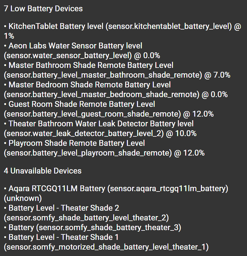

@Blacky
I understand your thoughts on using Labels (I use labels often) I think using labels for this 1 purpose is 100x more admin work vs placing it in one blueprint. Especially for those of us that have hundreds or entities
real world example…
using your blueprint my report looks like this…
KitchenTablet Battery level @ 1%
Aeon Labs Water Sensor Battery level @ 0.0%
Master Bathroom Shade Remote Battery Level @ 7.0%
Master Bedroom Shade Remote Battery Level @ 0.0%
Guest Room Shade Remote Battery Level @ 12.0%
Theater Bathroom Water Leak Detector Battery level @ 10.0%
Playroom Shade Remote Battery Level @ 12.0%
Aqara RTCGQ11LM Battery is unknown!
Battery Level - Theater Shade 2 is unavailable!
Battery is unavailable!
Battery Level - Theater Shade 1 is unavailable!
Low battery level is unavailable!
Low Battery Level is unavailable!
From an administrative / user standpoint, labels are a lot more work and more complexity to ā€˜remember’ they must do. Vs simply adding 1 line in the blueprint filter.
These are entities that are in a lot of devices and most people dont even know or will never need, see or touch (like Low Battery sensor).
With labels they need to ā€˜know’ to do it and add a label after every device they add.
with my method the user adds 1 simple text pattern to exclude ALL entities, forever. Takes 3 seconds to add, instead of 100x as much time and the need to look at and maybe modify every battery device when adding a new device.
In 3 seconds I add low_battery_level and all the ā€œLow battery level is unavailable!ā€ messages are gone forever, and I never have to edit a single entity.
oh, and I also added some options to make it easier to read and see Entity ID (optional, can be disabled or only show ID and not Name) and what devices are actually unavailable, vs devices that have the sensor and do not report properly. Thus my report looks like this…
