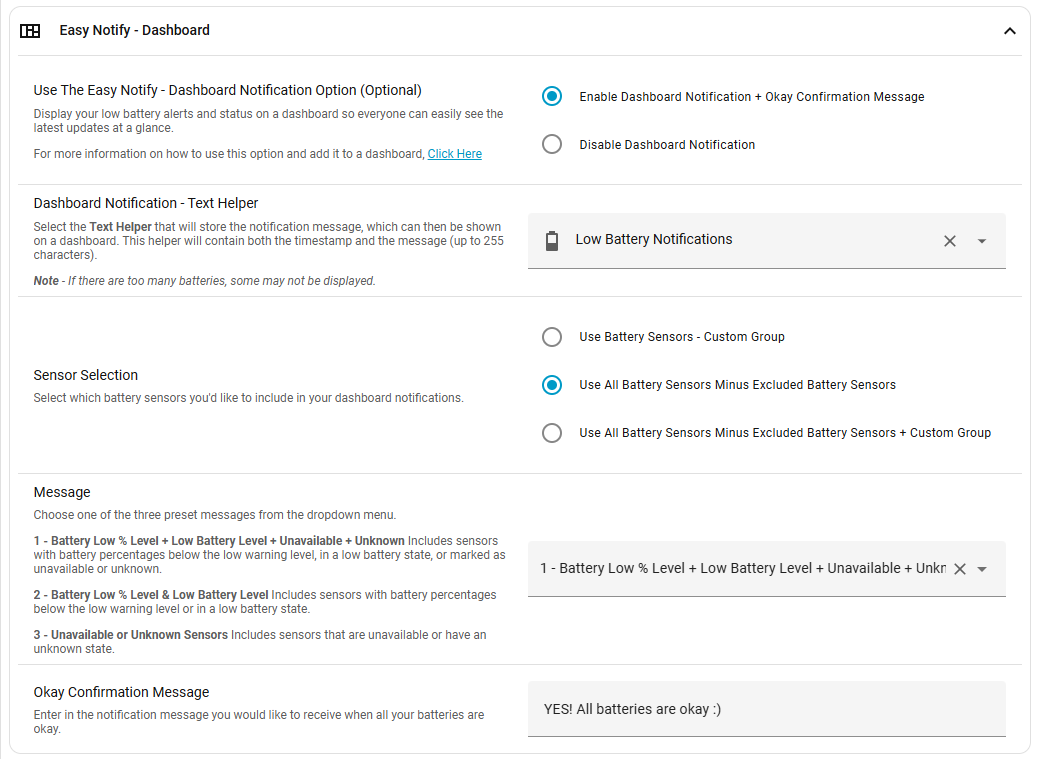

I don’t seem to have a “Create” option or “Advanced” settings as described in the FAQ. Here’s a screenshot of what I’m seeing.
-Thanks
@zBernie
All you settings look good.
Your text helper is Low Battery Notifications. To find all your helpers you have created go to Settings > Devices & Services > Helpers (tab at the top). There you will see your Low Battery Notifications text helper. Click on it and then click the cog wheel. Now you see the options.
The thing to note is once you created this text helper it will be empty and there will be no text formatted in the correct way. In order to create some text you have to run the automation just once so it will populate the text helper. Then when you add it into the dashboard everything will work.

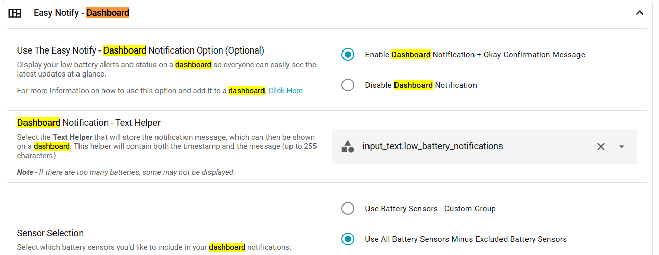

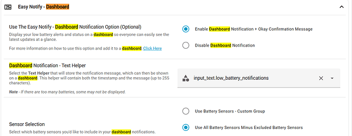

I got a strange “Batterie is Unavailable! " Without any Sensor Name on the dashboard. In addition I get no notification on my cellphone which tell me, no sensor is detected as Low Batt. If i am activating the OK confirmation, I get the notification with “YES! All batteries are okay :)””
and looks the “all_sensors” is also not Empty
Do you have an idea where is the bug on my system?
thanks a lot

So when it says Batterie is Unavailable! the name of the battery is Batterie and the blueprint adds is Unavailable!. So you need to search for Batterie in settings > device & services > entities tab at the top and then search Batterie. You can also use the filter to see the Unavailable.
For the 2 displaying different I would need to see your YAML of you settings. If you like could you please provide us your YAML of the automation? This YAML code are the settings you have selected in the automation so I can help. To do this go into your automation, top right 3 dots, Edit in YAML, copy all the code, come back to the forum and in your reply at the top tool bar click on “</>” and paste code in there.

  1. In your device notification in the message selection you have chosen option 2. See the description of that input. Option 2 will not show Unavailable + Unknown sensors.
  2. In your dashboard notification in the message selection you have chosen option 1. See the description of that input. Option 1 will show Unavailable + Unknown sensors.

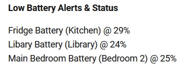

New Update 3.3
Stay Charged, Stay Smart! Customize it your way and let’s automate your battery maintenance! :battery::zap:
:new: Battery Sensors - Report Fields
You can now choose which fields are included when your battery sensors are shown in the low battery notification. The new option is in the Battery Settings section.
You can choose multiple options, but you must select at least one. Previously Friendly Name was hard coded. Available options now are:
  • Friendly Name
  • Floor
  • Area
  • Device
  • Entity ID
The fields will be reported in this format
Friendly Name {Floor} (Area) [Device] – Entity ID
Any field you don’t select (or that isn’t available for the sensor) is simply left out.
