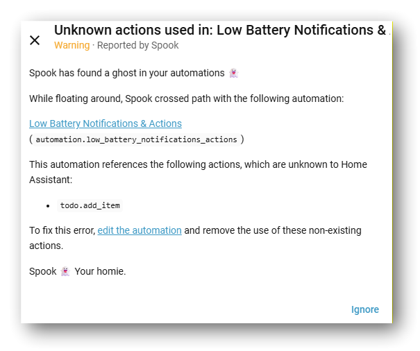

Second, I’ve gotten a warning from the Spook add-on of an unknown reference in the script. Can you confirm whether that’s safe to ignore or if there’s something I should tend to?

For the second one I going to do a FAQ now on it as it gets asked all the time. See below this post.
Blacky :grinning:
FAQ - Why Does Spook Give A Warning For To-Do?
In this blueprint, you have the option to add your low-battery report to a To-Do list using the Easy Notify – Device Action Buttons.
The To-Do integration is provided and maintained by Home Assistant, but it is not installed by default. If you want to use it, you’ll need to add it manually.
You can find the integration here: Home Assistant – To-Do Integration
If you haven’t installed the integration yet, Spook may detect that this blueprint references the todo integration but can’t find it, and will show a warning.
You have two options:
  1. Click Ignore on the warning if you don’t plan to use the To-Do integration.
  2. Install the To-Do integration in your Home Assistant instance.
This is completely safe, the integration is official and maintained by Home Assistant.
Enjoy
Blacky :grinning:
Back to FAQ: Click Here

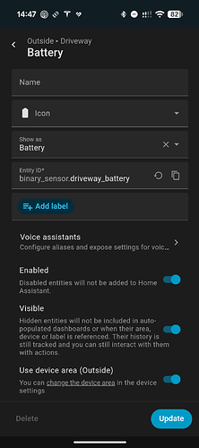

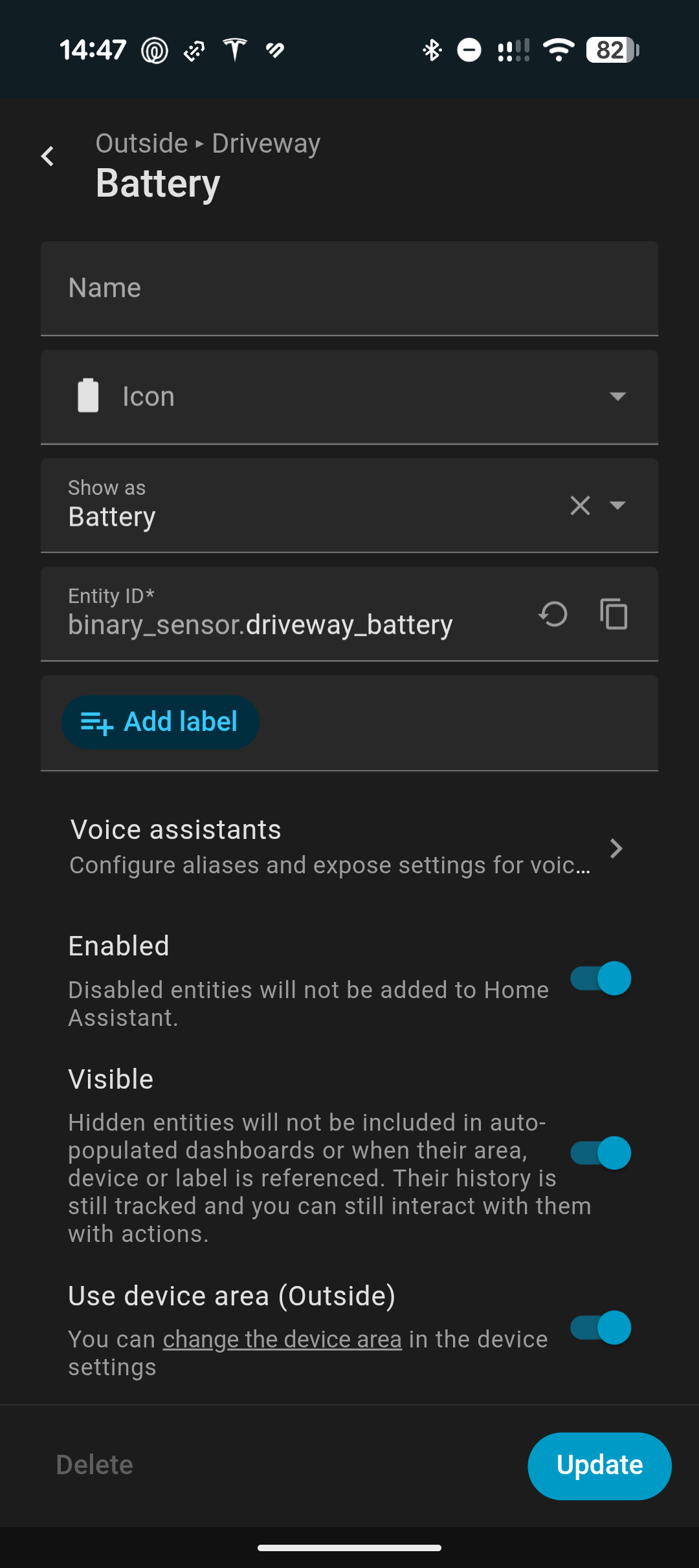

Would it be possible to add Blink cameras ? They are not found by the blueprint. The entity looks like this
Any feedback ?
