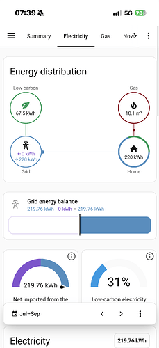

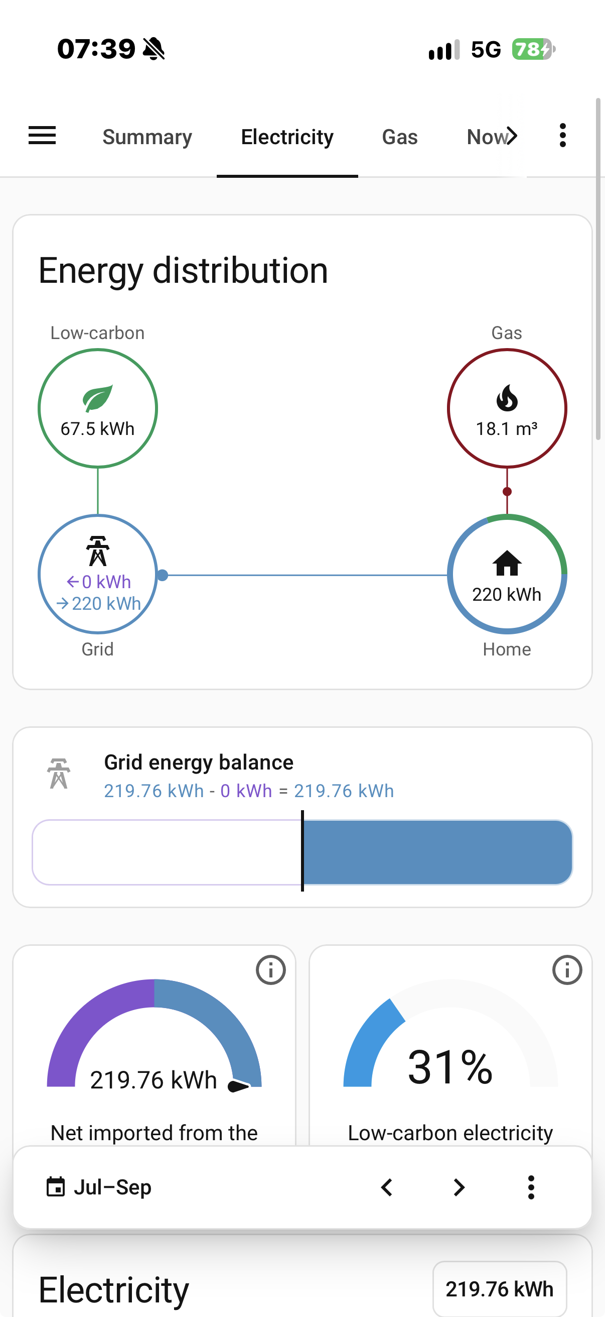

Low-carbon dashboard doesn’t work

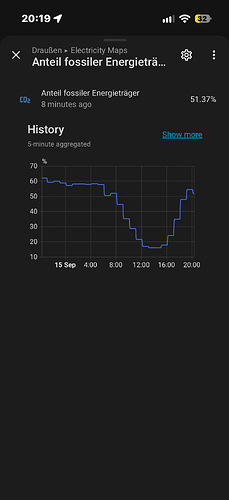

the Electricity Maps integration is working correctly and shows a valid fossil fuel share, for example 51.37%.
However, the Home Assistant Energy Dashboard always displays 0% low-carbon electricity consumed.
The grid import itself is shown correctly, so only the low-carbon percentage seems to be wrong.
Has anyone seen this before or knows why the Energy Dashboard is not using the Electricity Maps value correctly?
Thanks!
Just to clarify: the Electricity Maps sensor itself works correctly and the data is available in Home Assistant.
The issue seems to be only with the Energy Dashboard display/calculation, which always shows 0% low-carbon electricity.

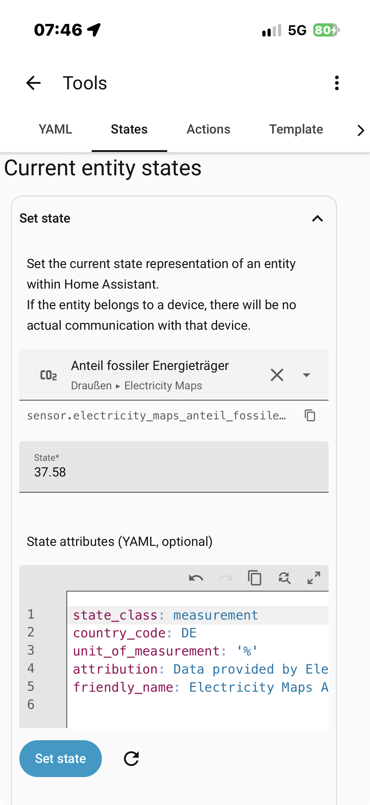

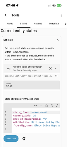

However, it would also be important if you show this “sensor” configuration/definition, so people know how it looks like.
i.e
Does it have correct device-class & state-class etc
So Click on /Settings/Tools, choose States, and find your Entities there, and post i.e a picture of it’s Attributes
When I zoom out. It works. Only in small time periods not.

Ist this the picture you asked for? @boheme61
