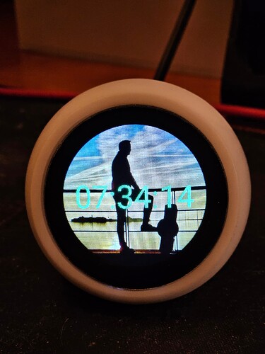

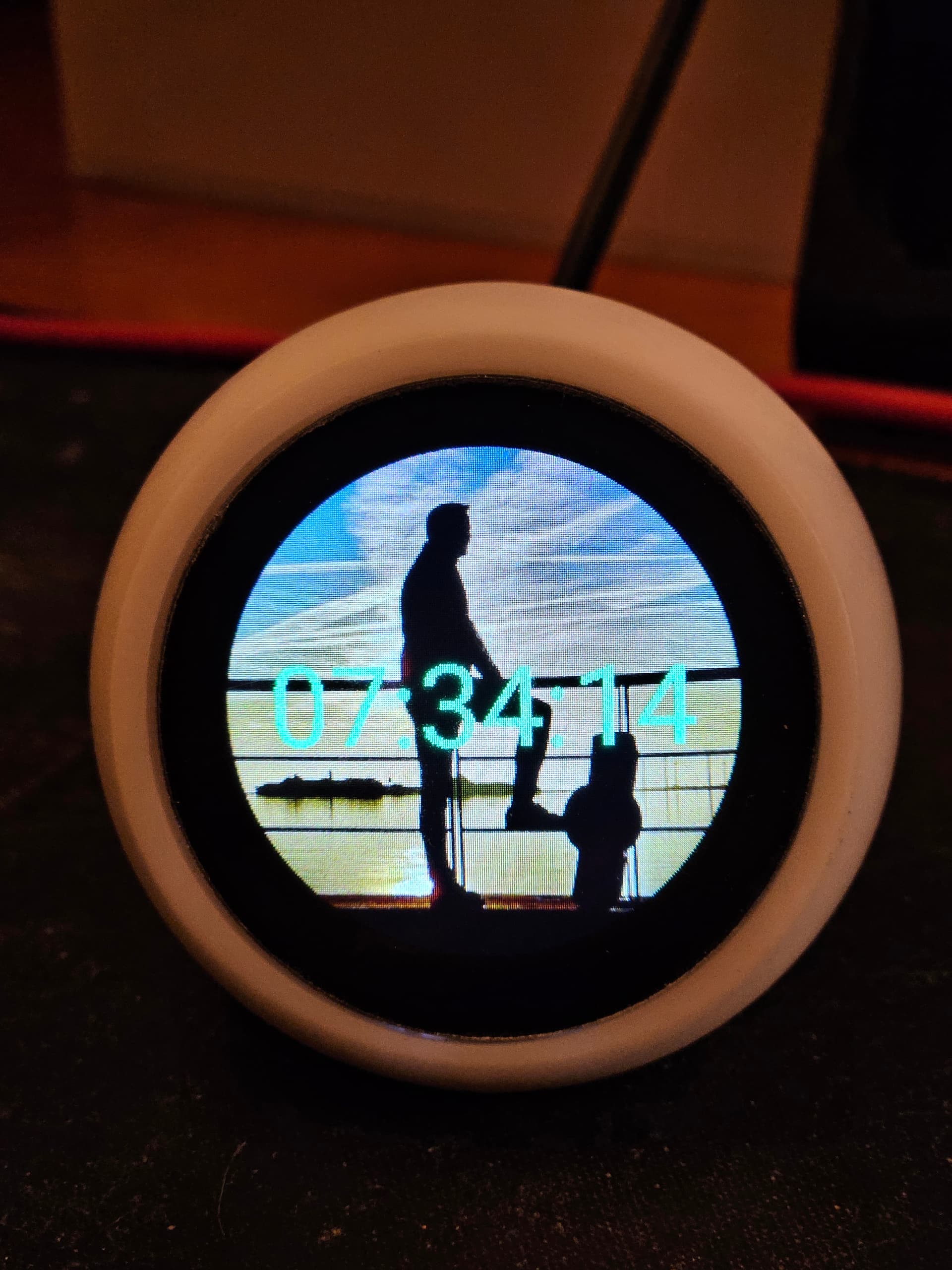

i will add the display part to your code:
time:
  - platform: homeassistant
spi:
  clk_pin: GPIO14
  mosi_pin: GPIO17
  interface: hardware
font:
  - file: "gfonts://Roboto"
image:
  - file: images/ow480x480.jpg
    resize: 240x240
    type: RGB
display:
  - platform: ili9xxx
    invert_colors: true
    model: GC9A01A
    rotation: 0
    reset_pin: GPIO18 # (Pin on display - RESET)
    cs_pin: GPIO13 # (Pin on display - CS)
    dc_pin: GPIO10 # (Pin on display - DC)
      auto red = Color(255,0,0), green = Color(0,255,0), blue = Color(0,0,255), yellow = Color(255,255,0), white = Color(255,255, 255), cyberlightgreen = Color(0,255,159), cyberlightblue = Color(0,184,255), cyberpink = Color(214,0,255);
      it.image(0, 0, id(my_image));
      it.strftime(120, 120, id(roboto_52), cyberlightgreen, TextAlign::CENTER, "%H:%M:%S", id(homeassistant_time).now());
this will show a image with the time on top.
