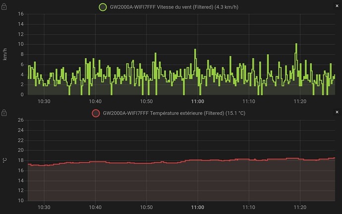

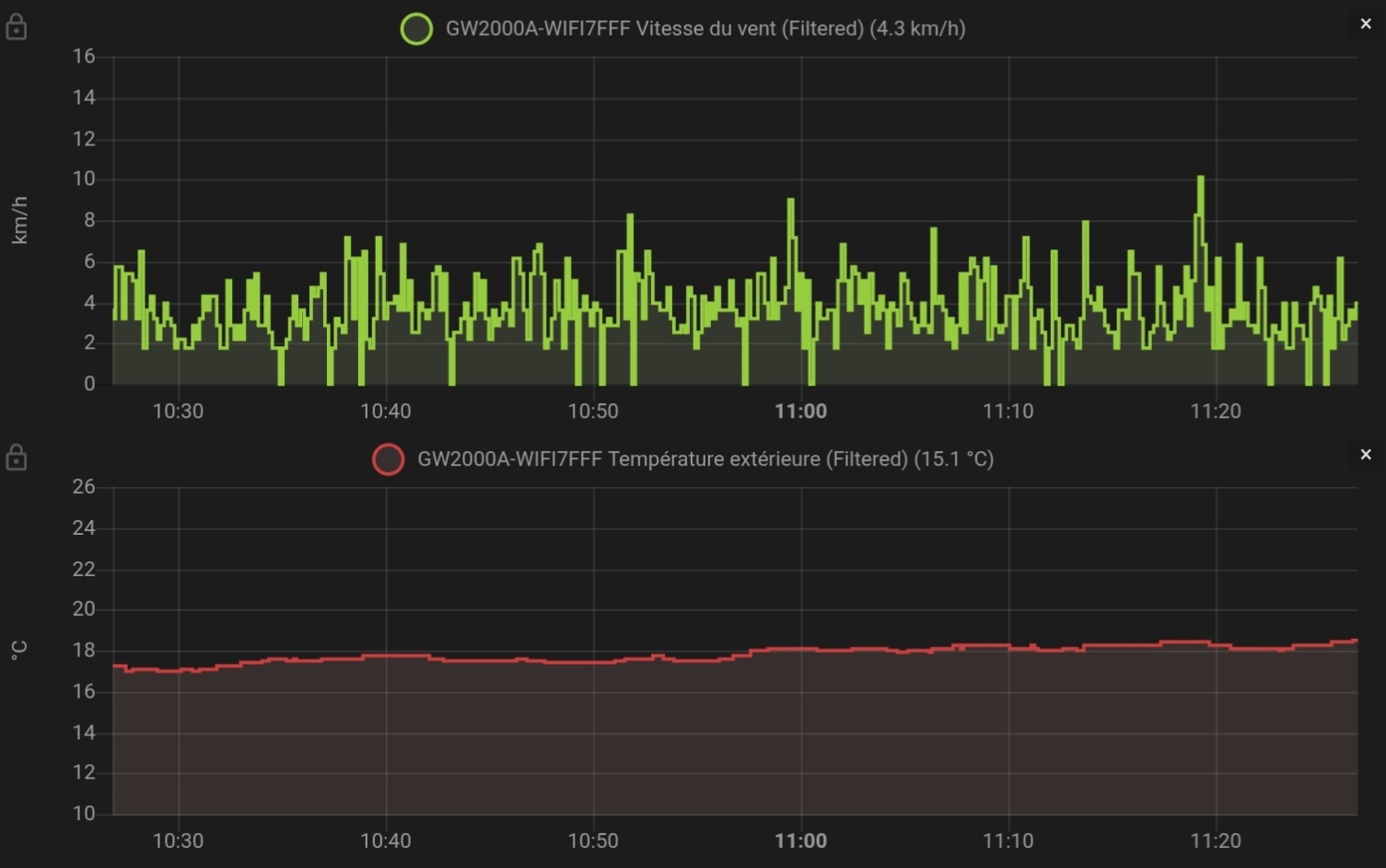

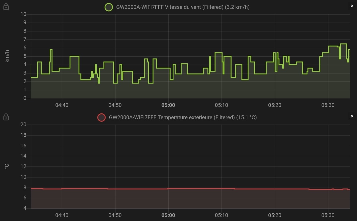

Green is a noisy source (wind speed), red is a very stable one (outdoor temperature) — note the multiple updates for nearly identical temperature values.
Stepped representation is used here to make updates visible. A curve representation would of course be smoother and more visually appealing.
Before:
After:
Wow this is gamechanging. It might even need to become a default feature, with a setting that can be enabled as an aspect of each numeric sensor.
